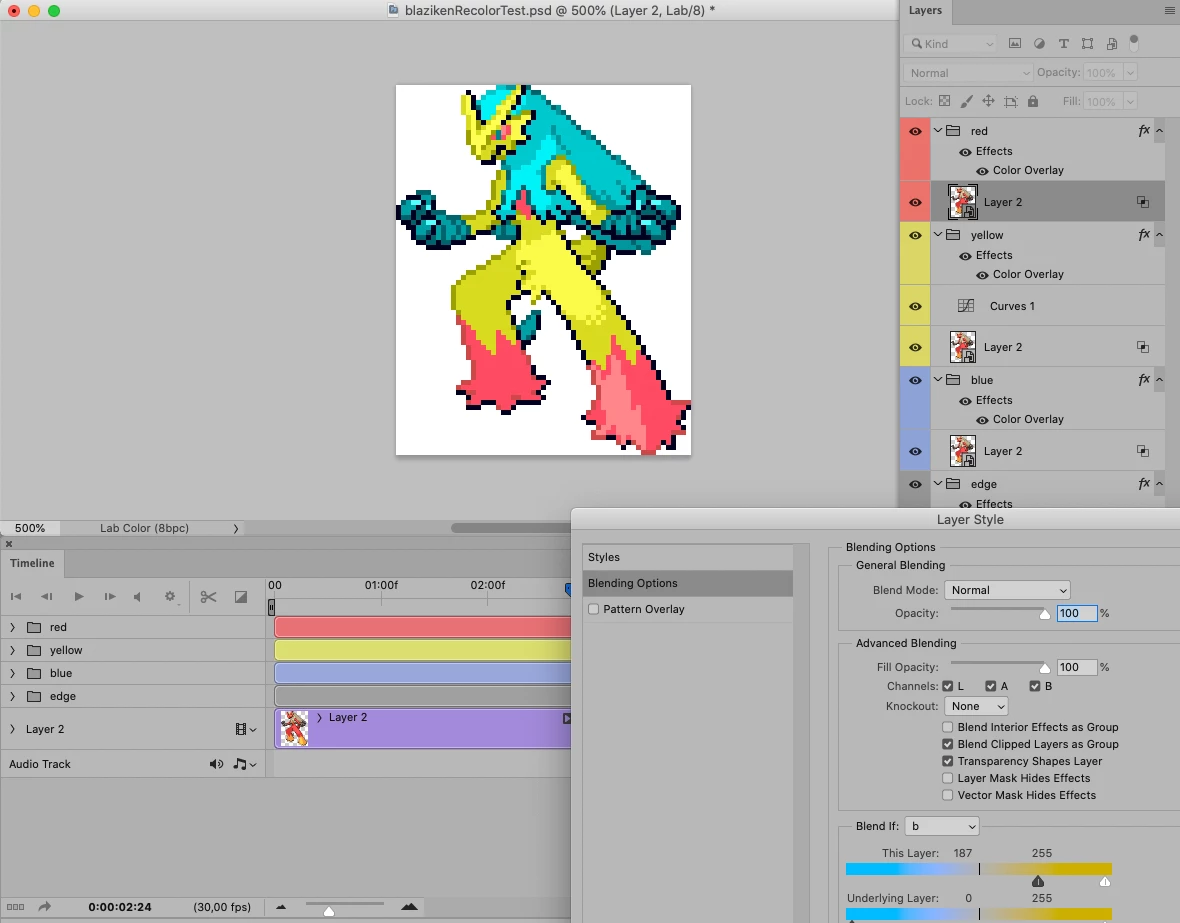

But I would prefer using Video Layer instances to isolate the various elements and colorize the separately (in Lab).
Here are examples of isolated elements and the complete result (not at full length though):

The image seems like a bad basis for the color changes.
One option would be to edit the Color Table on exporting.
