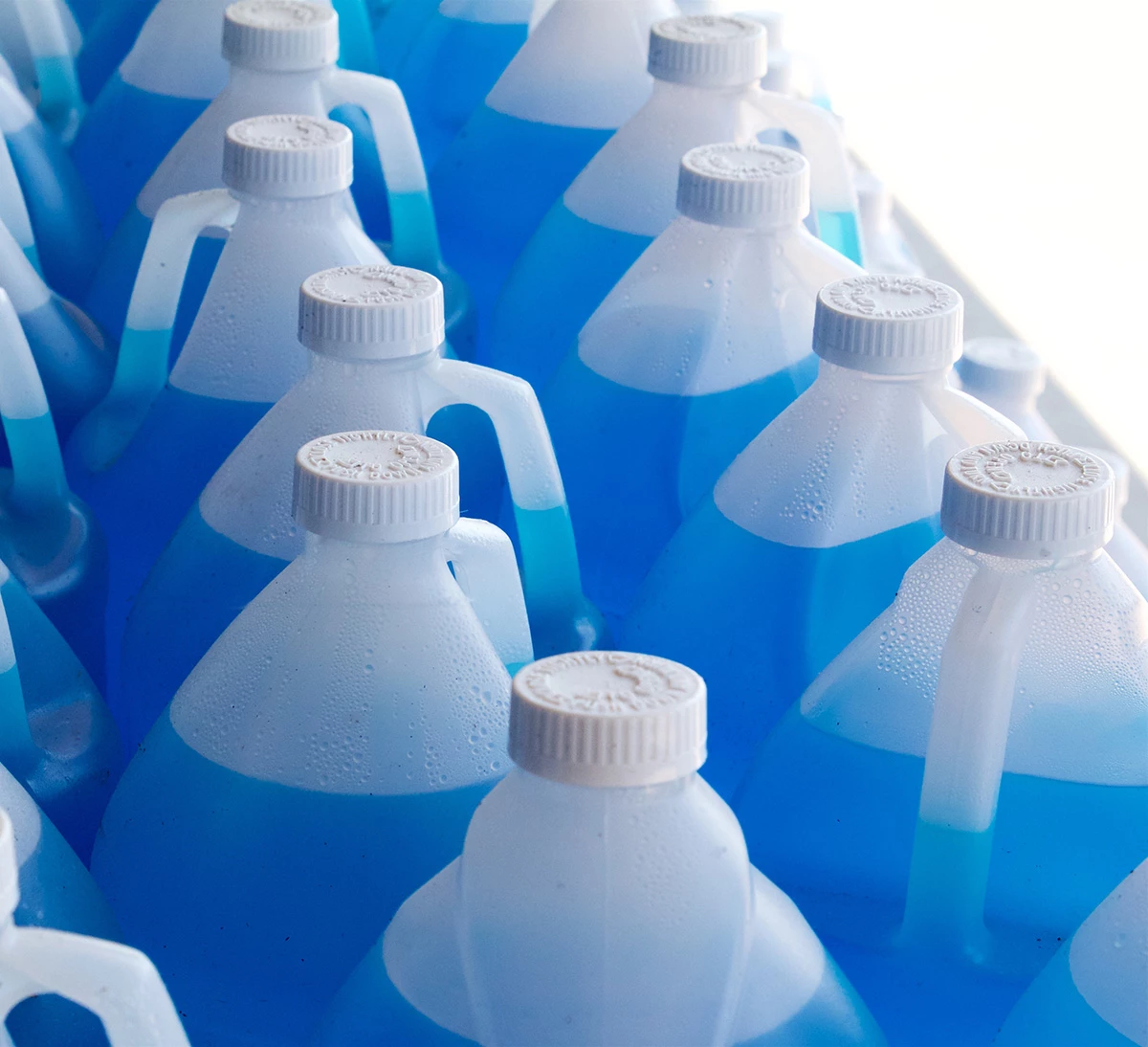

This is my first post.  I'm fairly new to Photoshop but have had some good success so far.  I am using Windows 11, Photoshop 24.
I have a photo of some jugs with fluid in them.  The original photo has blue fluid.  I need to change the color of the fluid to:  magenta, green, purple and orange.  I have successfully changed the colors to magenta, green and purple but I can't seem to get it to orange.  Any suggestions?  See attached photo.

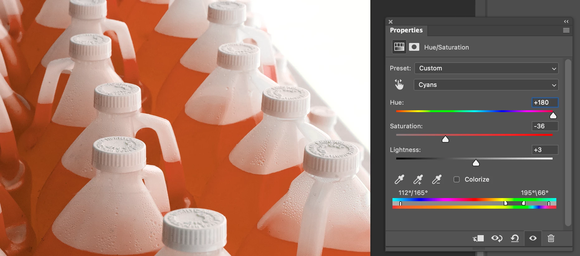

I would use a Hue Saturation Adjustment Layer and choose the Cyan channel to adjust the hue accordingly:
From there you can adjust levels, etc to brighten the image.
Kevin Stohlmeyer
November 30, 2022
Added bonus - you can also use the mask attached to the layer to isolate your adjustments further.

Thank you!  In between our messages, what I did was
1. Changed the color space to LAB.
2. Selected a color range.
3. Made a Hue / Saturation Adjustment Layer to get to the desired orange.
4.  Made a Brightness / Contract Adjustment layer.
This worked.  But, your method obviously worked too.  THANK YOU.
