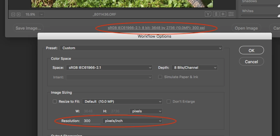

    When opening raw camera files through Adobe Camera Raw, one can also set the PPI value in the “workflow” text at the bottom centre of the ACR interface (click on the hypertext):
    As previously mentioned, the PPI value is stored in metadata. If you wish to change this value on saved images it could be performed using an batch action or image processor script+action to resize to 300ppi with resampling turned off – however I would not recommend doing this for JPEG files as it will decompress/recompress them which is not best practice for a lossy compressed file (even  if the quality loss is next to invisible). I would use ExifTool to batch update the PPI metadata in the files without affecting the actual image data.
