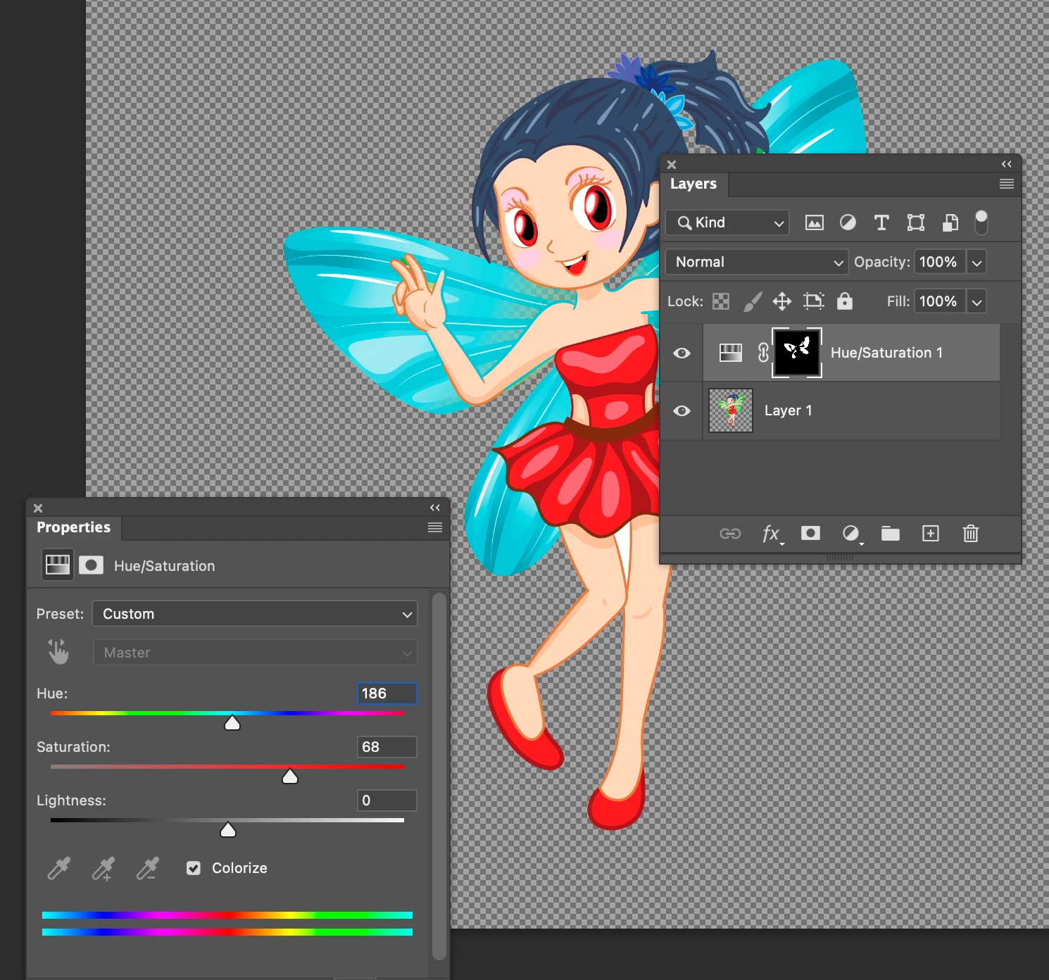

Use a selection tool like quick select or magic wand to select the dress or wings (one at a time).
Once you have your selection, add a hue saturation adjustment layer.
Then click the "Colorize" check box and adjust the hue and saturation.
Return to the original layer and select the other object and repeat.

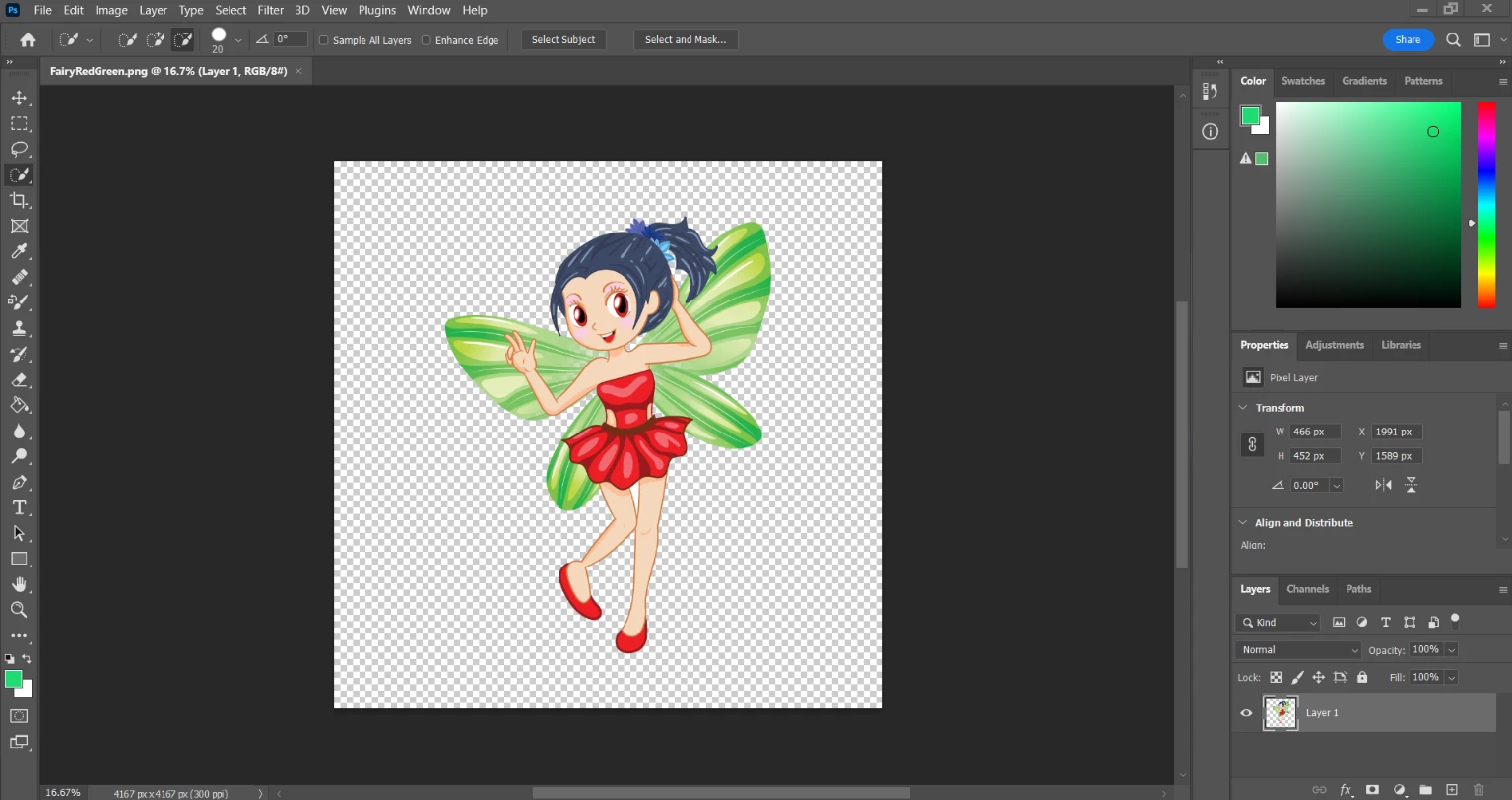

Unfortunately, the photo above bears no sresemblence to what I have. I am using Adobe Photoshop 2022, release 23.4.2. I hope it's not too big, but I have attached a screenshot of what I have(I have already selected the top of the dress). Also, You said "Once you have your selection, add a hue saturation adjustment layer". How do I do that? Do I use the menu on top or the tools on the right side? I'm a newbie, I need everything explained.

I moved the panels out so I could capture everything in one screen shot. Look at the titles of the panels and you see them on the right.
The bottom of your layers panel has a black/white icon - that is a pop out menu for adjustment layers.
