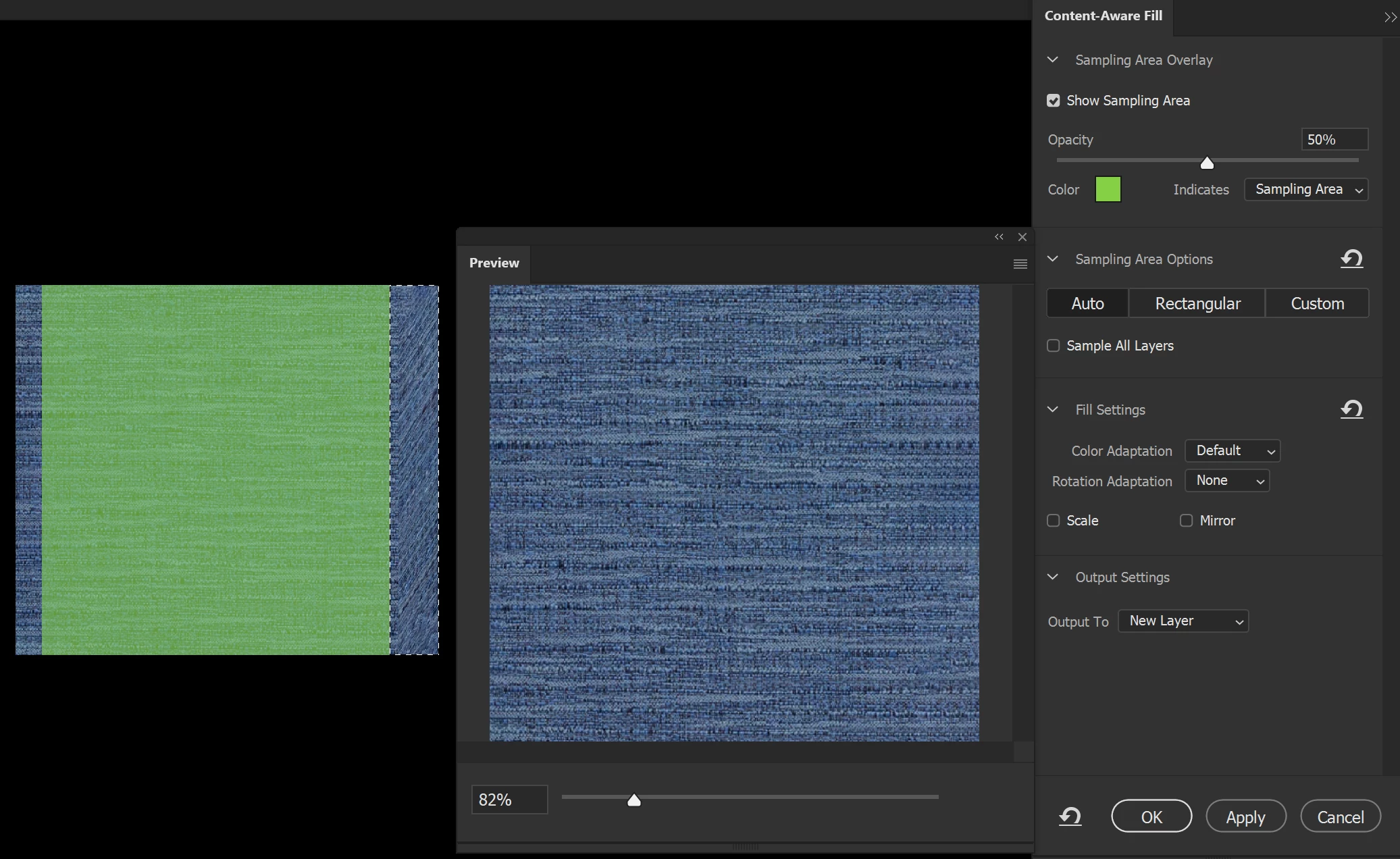

Assuming that the extended background is going over an area that has no pixels, you could start by using content aware, as you are doing now. Then select the warped area.
Choose Edit > Content Aware Fill. This command lets you choose the area to fill from, and you get a preview. After you click OK, it defaults to putting the adjusted fill on a separate layer. If it looks good, merge the two layers.

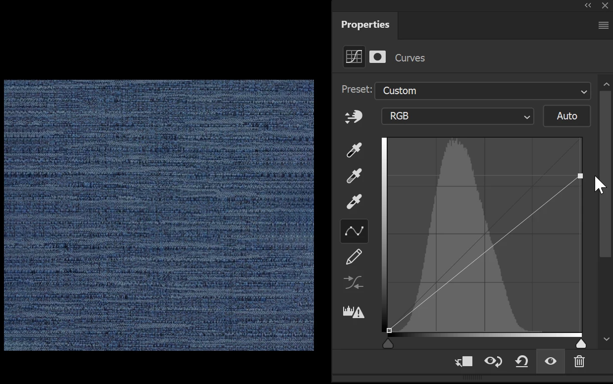

Moving on to the second question about deepening the background color. Hue/Saturation is a good suggestion from war_unicorn.
Another way would be Curves.

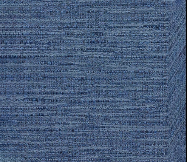

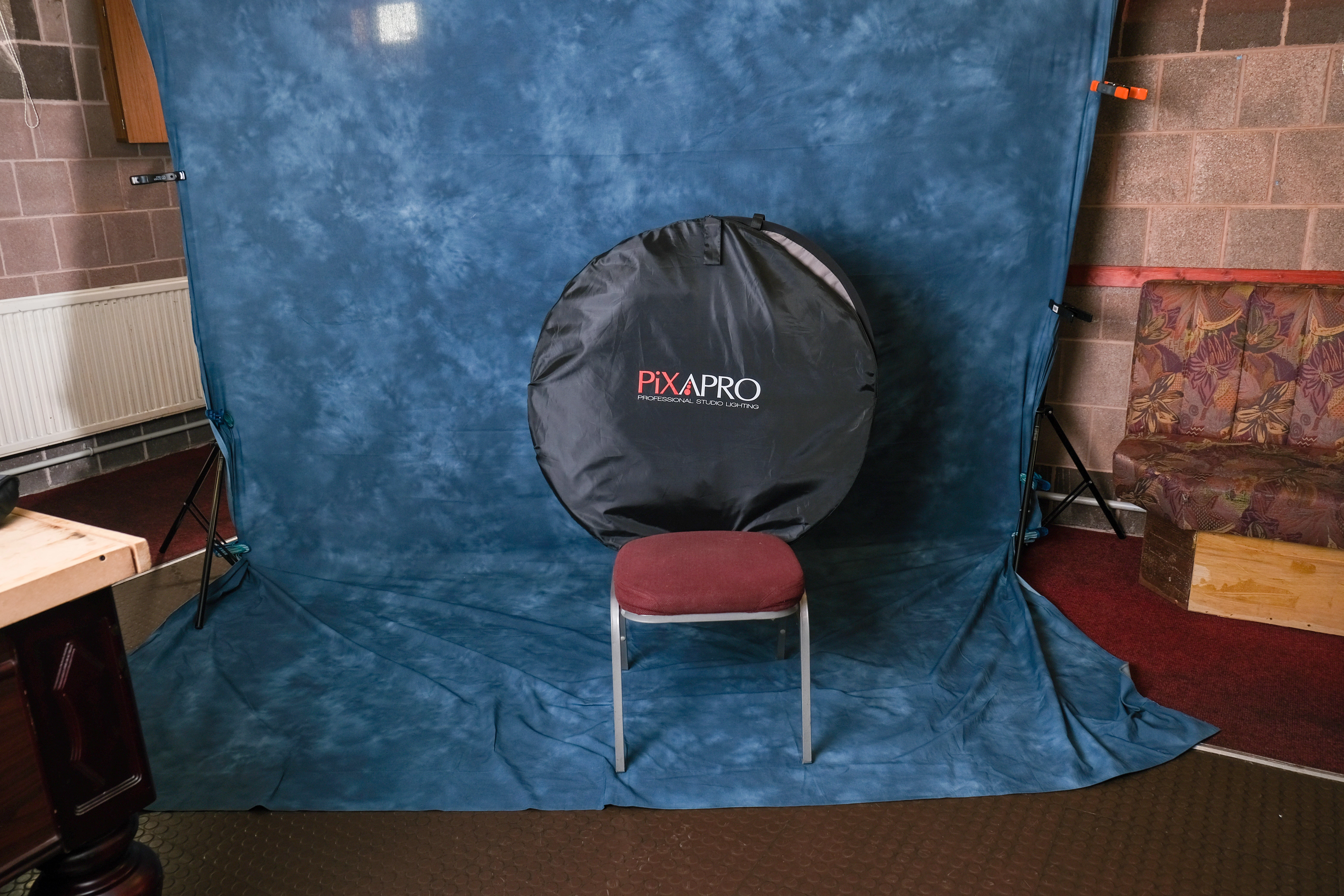

I have attached the setup I was using, no people in it. Most of my shots were for one / two people and were 3/4 length poses. However, I have group photos to take with a max of 5 people and it is in a very small confined area. I was practicing extending the background to cover the wall and floor but the method I was using was making areas I was extending the background into looking warped.
I was using the marque tool, selected a clean area, used the free transform in the menu and stretched this over the “wall”

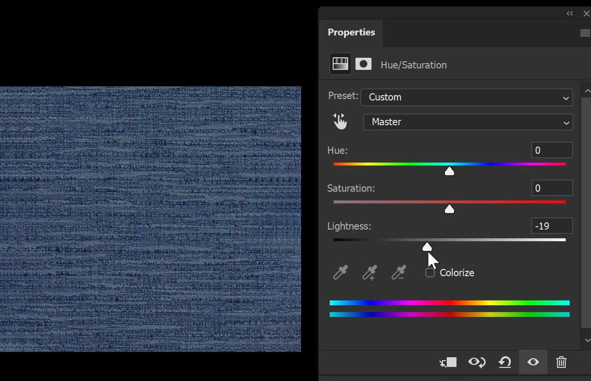

for the second point, select the background, you can select subject annd separate the background, go to layers panel, click on create a new fill or adjustmennt layer, Hue/ saturation, move the saturation slider to left as you wish.
you can try curve also (only on the background)

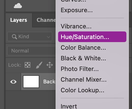

1. How far are you going? Which way? Vertically? Can we see a sample of what you're trying to achieve?
2. In its most basic form: A Hue/Saturation adjustment layer. (Can use other methods like a Curves adjustment layer, which will let you "dial it in" even more with its advanced controls, but baby steps.)  🙂  Obviously, since you want to affect only the background, you'd want to select the background first and then invoke a Hue/Saturation layer adjustment so that you start off with the background masked.
