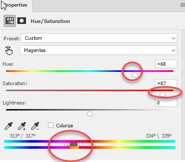

If it is all on one layer. then again you can use Hue and Saturation adjustment layers but this time with masks added to operate on specific areas and the color selection, in the Hue & Saturation layer properties,  used to target specific colours. Example below:
Hue/Sat layer 1 example changing the pinks to orange:

In Hue and saturation you can choose a color group with the top dropdown box. That puts the sliders on the colour bars below. You can then move those sliders to set what colors will be affected.
Also, the orange on the right seems a bit pixilated, do you think it should be a color change rather than messing with the saturation?
By adjusting the sliders you can choose how much to change the color and whether to soften the transition.
