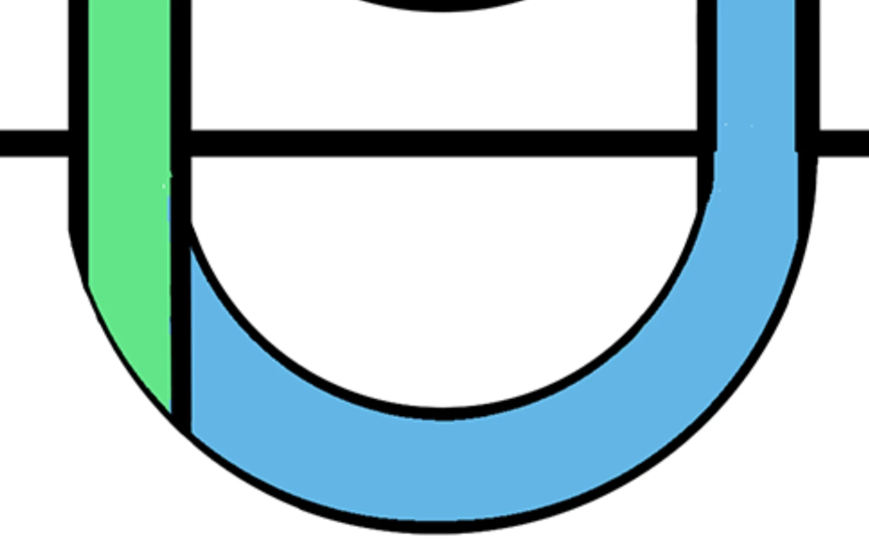

Hey everyone ,
I was wondering if I could get some advice ? Ive made up a watermark and Ive put them onto to some band photos to sell them but they want the logo to be on a black background to be less of an attaction away from my photographs but cannot for the life of me find the option or workout how to do it ? I've been using photoshop for about 3 weeks now through starting college in September this year.
Thanks in advance
Tim
jane-e
October 29, 2022
@Tim26859369qpy7
One reason to keep components on their own layers is that they are easier to adjust. I like your logo, but the black lines need to be fixed before you go live with this. In Photoshop, you can apply a Stroke as a layer style.
If you have Illustrator, though, it is preferred for this kind of drawing because it is vector and can be resized. Photoshop is raster.
Jane
October 29, 2022
thankfully its not that noticable when its not that zoomed in, when I go back into college after half term ill get the table and pen out to smooth everthing out again
October 29, 2022
tablet*
Myra Ferguson
October 29, 2022
If you'd like the white background to be black, the black type and outlines to be white, and the color portions to stay the same then you can invert the image but preserve the color as a duplicate layer with a layer mask. Here's how (assuming the graphic is flattened):
  1. Duplicate the layer that contains your image (right-click in the Layers panel and select Duplicate Layer...)
  2. Click on the eye to the left of the new layer to hide it temporarily
  3. Select the original layer
  4. Invert it (Image > Adjustments > Invert or Control (PC)/Command(macOS) + I)
  5. Select the duplicate layer
  6. In the Toolbar, select the Quick Selection Tool (if you can't find it, use the Discover panel to search for it (Help > Photoshop Help)
  7. Draw on the green portion, hold Shift, draw on the blue portion, and draw on the coral portion (if you select too much, you can use a smaller brush &/or zoom in)
  8. At the bottom of the Layers panel, click the 3rd button from the left to make a layer mask
October 29, 2022
I'm just trying to get the logo on its own rather than have the white background but im new to photoshop and its seems like it should be dead easy to fix but I just dont know the software that well yet, I'm sure in time i'll be able to work magic with it ,
Thank you for the advice , I'll try and do those steps later on when my blood presure have lowered
Tim
