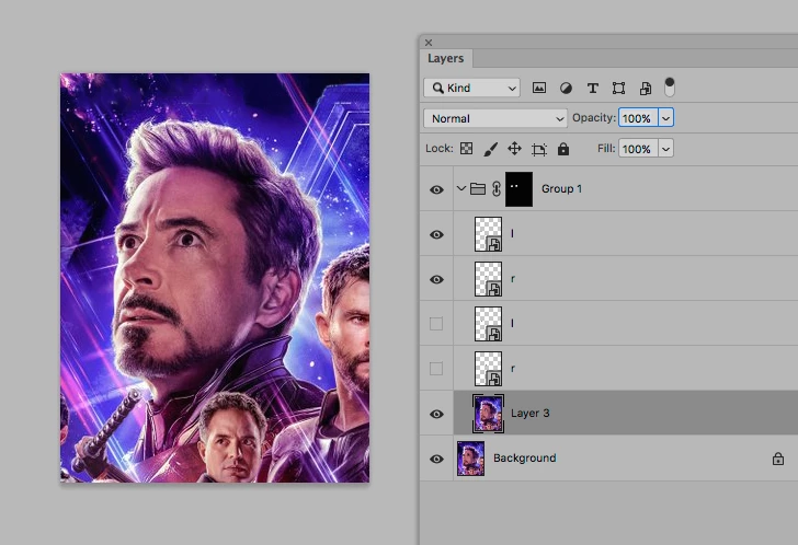

    Clip the iris and pupils onto Layers of their own (one for the left, one for the right) and fill in the missing parts.
    Paint in the white of the eyes where the it is and puppies currently are on a Layer of its own.
    Create a Layer Mask aperture of the eyelids and apply it to a Layer Group into which you put the Layers from above.
    Convert the iris Layers to Smart Objects and transform them as needed.
