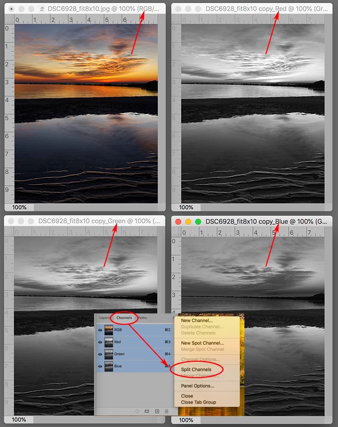

Split Channels, in one click, delivers three separate grayscale files, marked Red, Green and Blue. Choose the one you prefer and change its Mode to RGB for three identical channel values in the new RGB file.  Split Channels is in the drop down menu at the top far right of the Channels panel.  Note: Use this method on a duplicate file since the source file for the Split Channels command will no longer exist.
