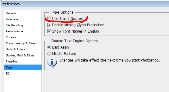

This one doesnt work notice the character is
activeDocument.activeLayer.textItem.contents="It’s";
but this does work
activeDocument.activeLayer.textItem.contents="It's";
note the character is
We have done a simple str_replace in php which will replace the first example for second.
But copy and pasting works fine for the first example, but doesnt in script and shows:
Also reference similar issues post
Inserting an apostrophe (char code '==39)
July 6, 2018
web2000Author
July 6, 2018
I tried that but it made no difference. I am on CS6

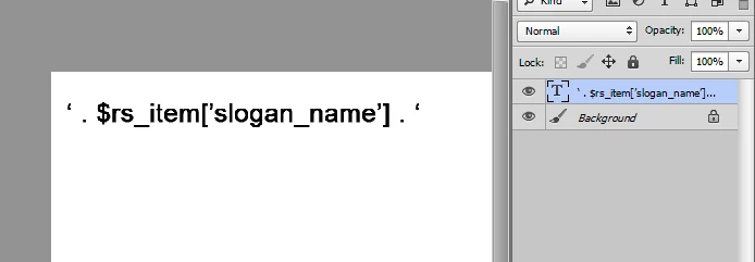

Most likely there is an encoding error
July 1, 2018
I do not understand.
In Photoshop, your code gives this text in the layer
Show the real code that is executed in Photoshop. (jsx file)
