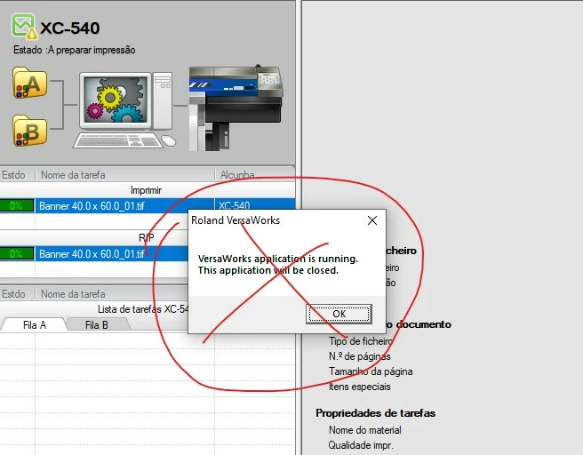

Hello everyone, everything good?
How do I check if the application (.exe ) is running through script? Thanks in advance.

mauricior6328708
March 16, 2022
Hi @r-bin, here in the latest version of photoshop/W10 it worked perfectly fine. great. Thanks for sharing.

mauricior6328708
March 16, 2022
Hi @Kukurykus ! I have a very complex script exporting in batch after performing some adjustments on images which then opens the "Roland VersaWorks.exe" printing software whenever it is executed, however, the problem is that if it is already is running, shows an unwanted message. My objective is to check if "Roland VersaWorks.exe" is already running, if it's true, don't run it again.
