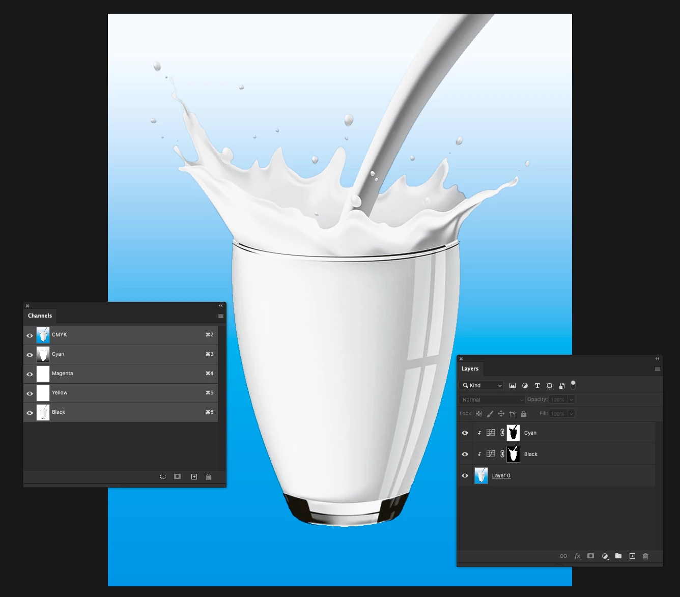

I am trying to create a script that will be executed based on whether the decision is true.  I want to add adjustment curve for each channel particularly (CMYK), only if that color exists on selected layer. It should look like on image below.

Can you explain how that solution solves your problem if you look for empty channels, not layers?
milevicAuthor
August 19, 2021
First I created curves with selection of each channel separately, then I used this script from the link to check each of those four (curve) layers and it works...
It may not be the most aesthetically pleasing solution, but for me as someone who is just researching scripting, it was enough that this script cover my needs 🙂
