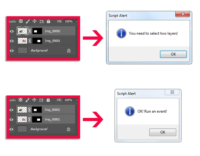

How do I check if I have two layers selected?
If you only have one or baby, trigger an alert message: "You need to select two layers!"
Thanks for the support

This is a good example, but I have not been able to modify it to make it capable of working the way I need it, I may not have been more specific in the question:
Does this image help you to understand? Thank you
It would be somewhat similar to checking for selected layers of this script. But this code is very difficult to understand.
