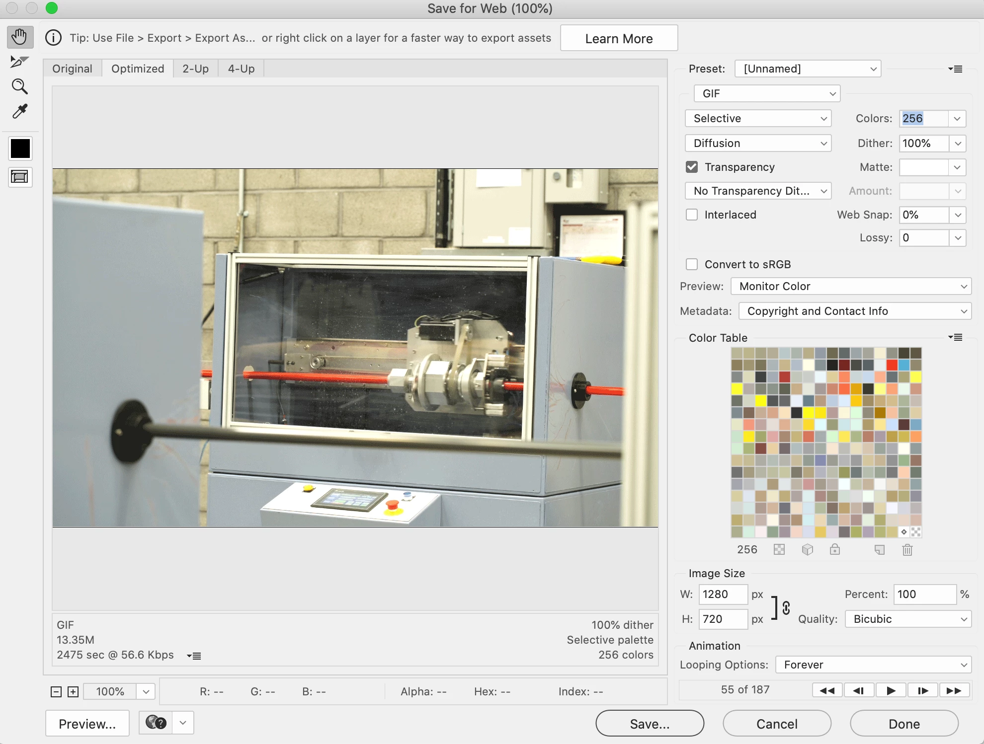

When exporting a cinemagraph from photoshop I get a message saying " Could not complete this operation. An unknown error has occurred." Any online searching to solve the problem suggests that there is not enough ram....and usually the person as 8gb. I have 16gb but admittedly on a slightly old MacBook Pro (late 2013 - the model before apple decided no body need useful ports). Basically, it runs the video slowly when going through the process of masking etc. Then I'm doing File >> Export Save for web (Legacy) >> and when the window opens for the settings I am doing:
Preset: Unnamed
GIF/Selective/Diffusion - transparancy is ticked - No transparancy Dither - I've tried both Covert to sRGB and not, and I've set the size down at anything from w500 to w1280 and it doesn't matter which I do it, thinks about it for a while, spinning wheel, and then the error message flashes up. I also tried increasing the amount of RAM that photoshop was allowed to access and it made no difference in handling. Normally I would chalk it up to an old computer, but it handles video perfectly well in other programmes so I don't understand why it wouldn't in adobe photoshop.

How many frames are there in the GIF you are trying to export?
Dave
December 17, 2019
See below Dave - I guess the frame number is the 55 out of 187 number at the bottom right?
