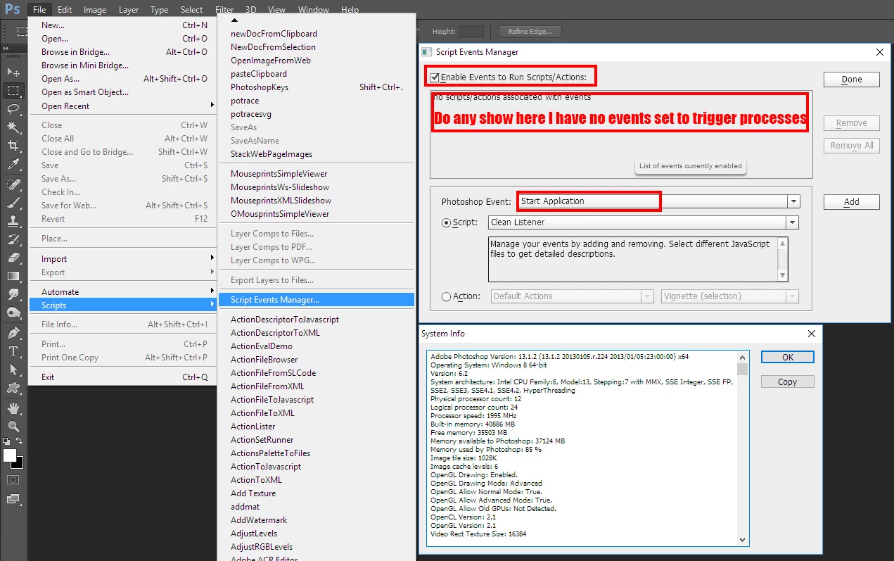

Photoshop CS6 should not do that.  I would think something you added to CS6 is doing that.
Use menu File>Scripts>Script Event Manager see if any event has be set to trigger when you start Photoshop.

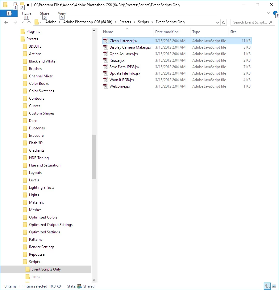

That is use to clear the Scriptlistener log file when you start Photoshop using the script event manager..  It belongs Photoshop Folder Presets\Scripts\Event Scripts Only. It should not be on your desktop. Perhaps you accidenlyt dragged it out and dropped it on your desktop.
