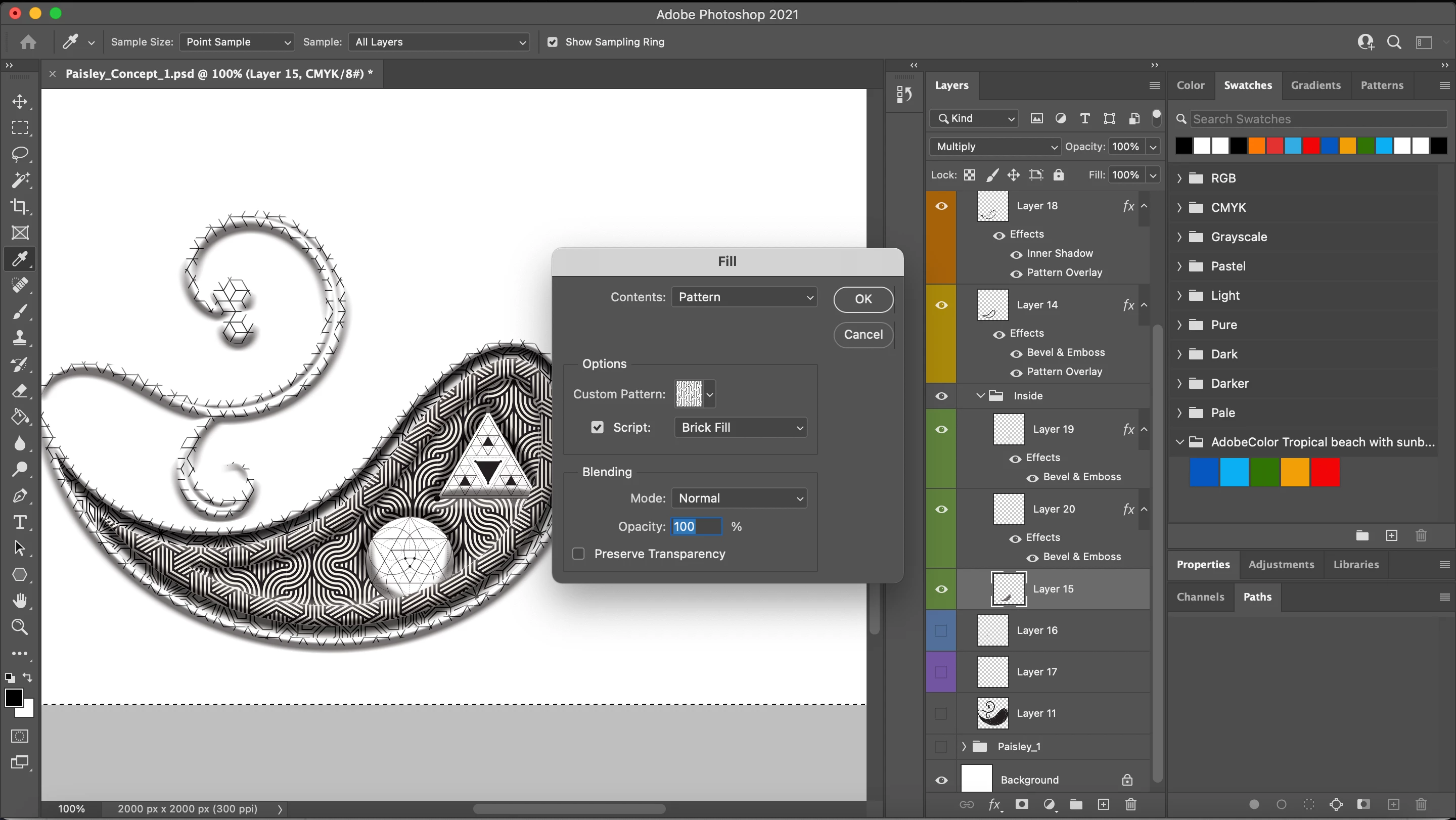

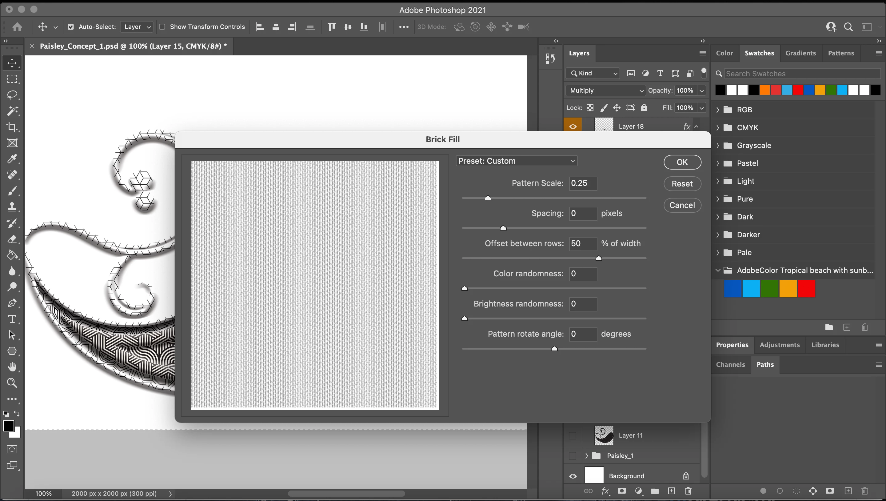

August 22, 2021
Shift Delete.  Pattern Fill.  Select the type of fill, which is beneath the Custom Pattern selector.  A diologue box will appear asking you about how you want the pattern.
