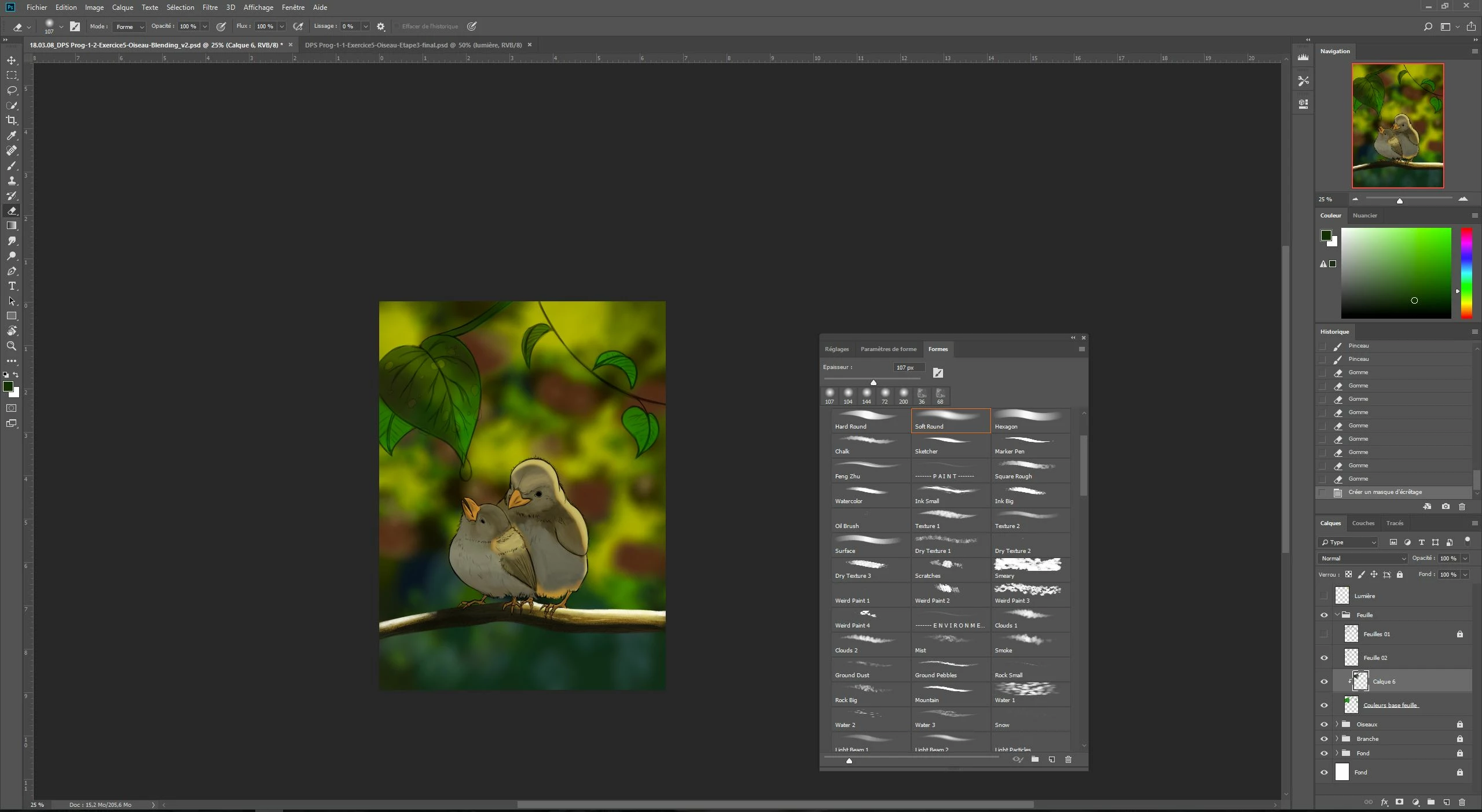

In this first capture, you can see the mask to do the shadows on the leaves is not clipped... Leaves, branch and birds are in separate groups. The colors of the branch and the birds  were done using clipping mask:. One for the flat colors, and others clipped on the basic one for the effects. in the case of the bird and the branch, the clipping masks worked properly. However... the color problem restarted with the leaves...

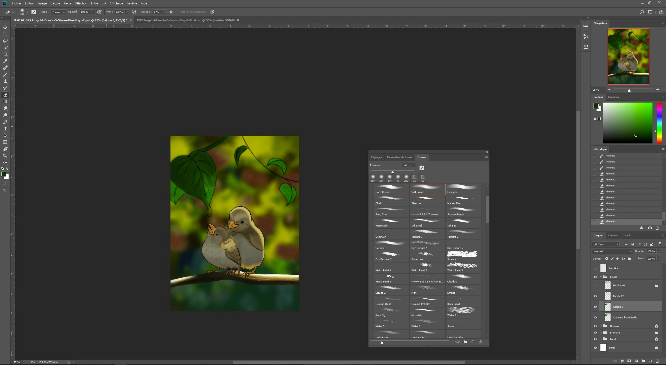

Below, you can see a capture of the same leaves. Now, in this one the shadow mask is clipped. That is the ONLY DIFFERENCE with the first image I posted but here's what I get in terms of colors:

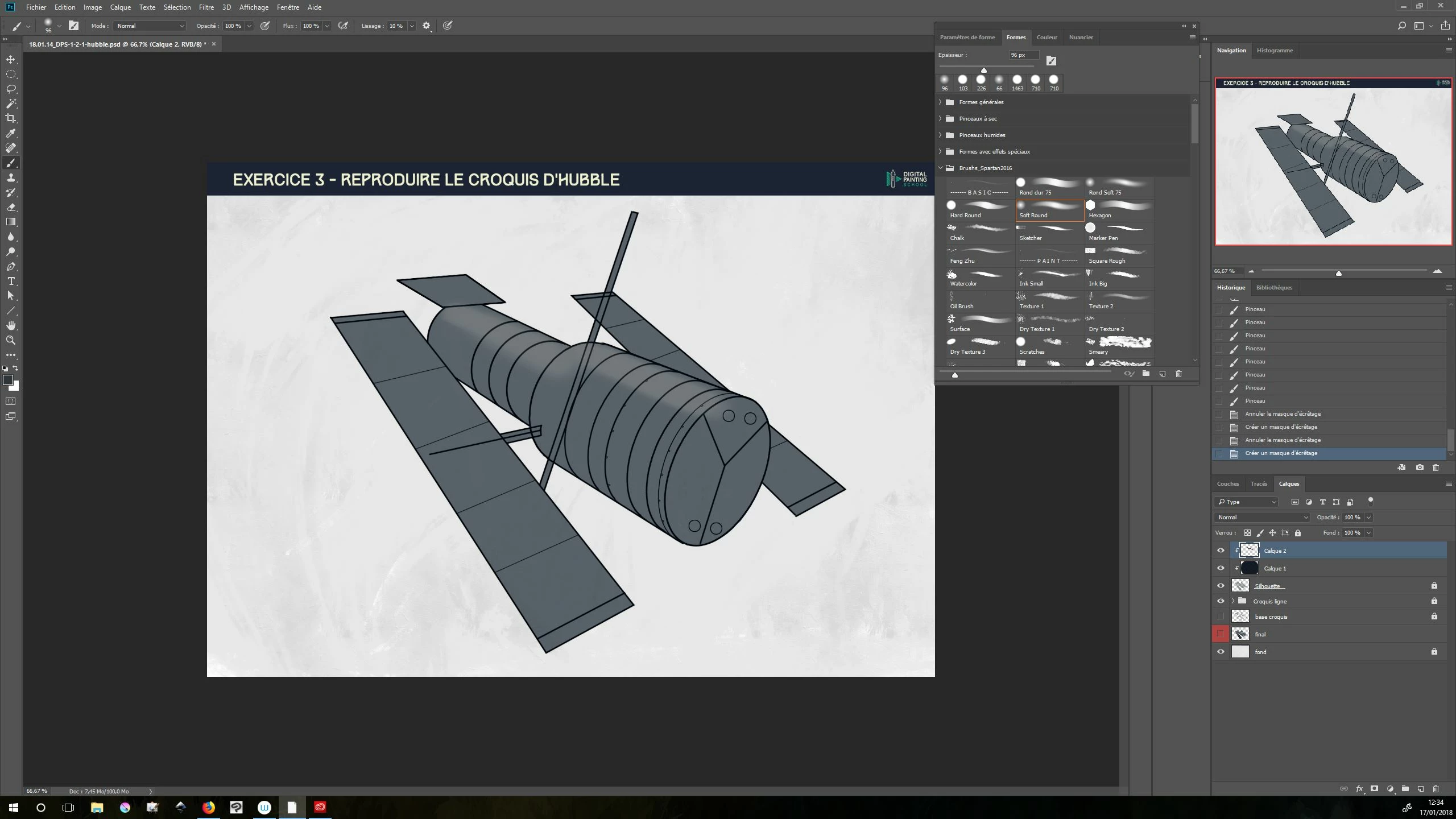

Here's another example:
Without clipping mask:
With clipping mask:
Depending on the color, the difference is striking. Even worse, if it's not clipped, I'll get a darker color while passing several times on the same spot... but once clipped, it doesn't change at all, it's like it's set on one color no matter the opacity of the brush chosen.

In both screenshots, the clipping masks are already selected although in the picture of the satellite, you can see two  clipping masks and both actually have the same problem.

I looked at the file (thank you for sharing it with us!) - the reason for the colour change is simple: your base layer (Couleurs Base Feuille) has an opacity set to 70%. When you use a clipping mask the "child" layers become part of it, and the entire clipping group becomes transparent.
To prevent this, double-click on the Couleurs Base Feuille layer, and turn OFF the "Blend Clipped Layers as Group. It will work as you want then.
