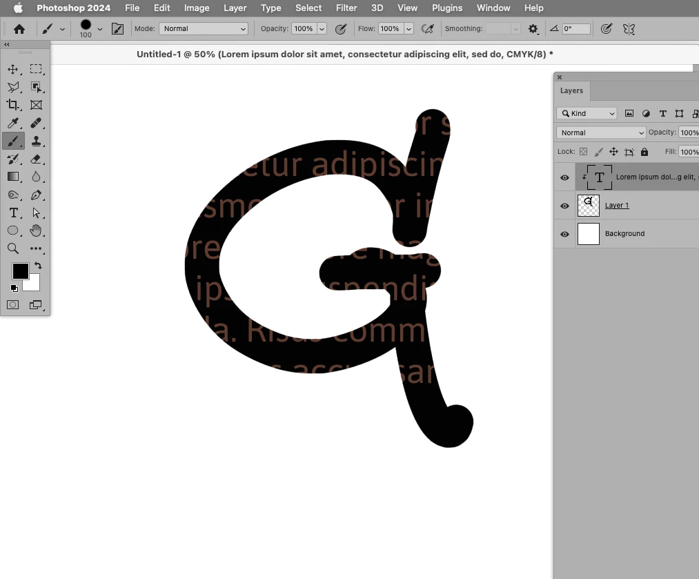

I have layers clipped to a base layer and I would like to remove the base layer and have the clipped layers retain the shape of  the original base layer. Is this possible? I feel its a simple answer but its just out of reach!
Is clipping masks the wrong way to do this?
Thank you

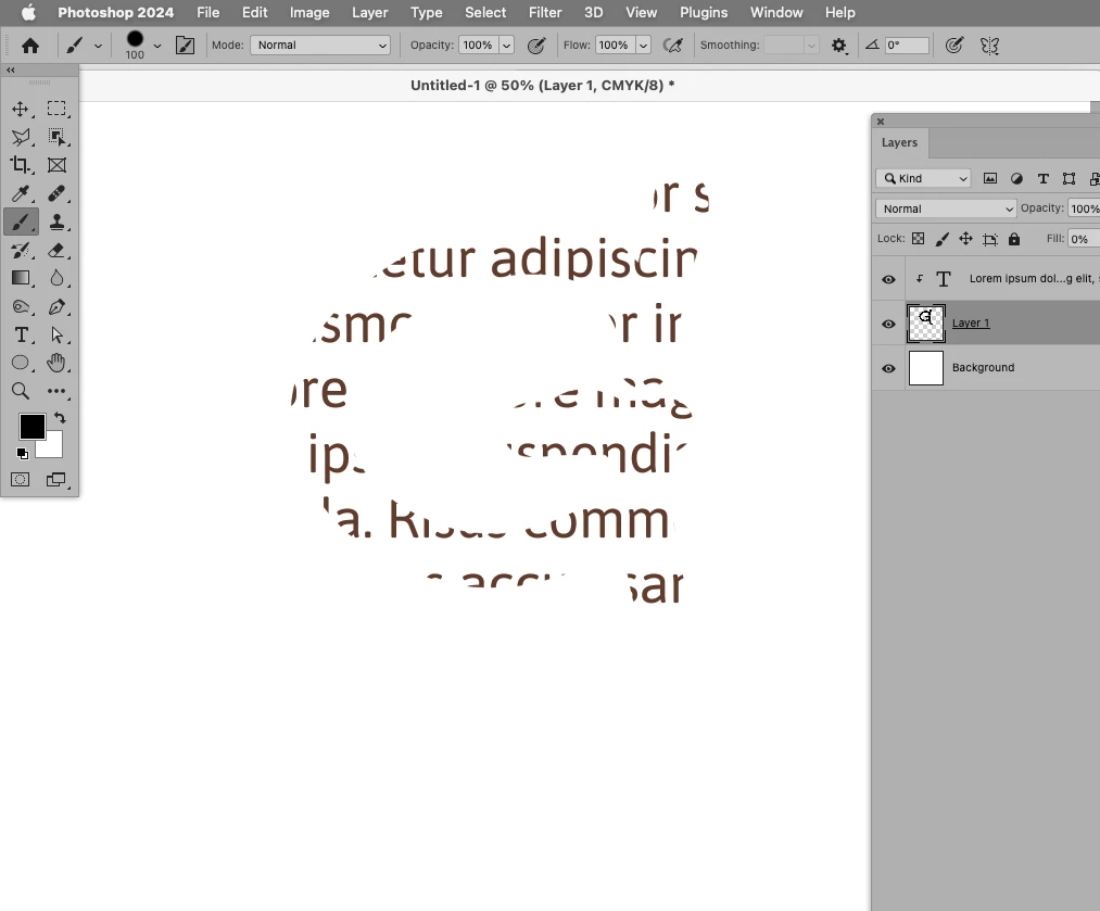

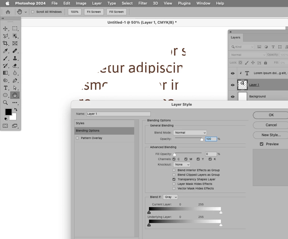

Try setting the base-layer to Fill 0% and uncheck »Blend Clipped Layers as Group«.

Works perfect! thank you so much really appreciated
