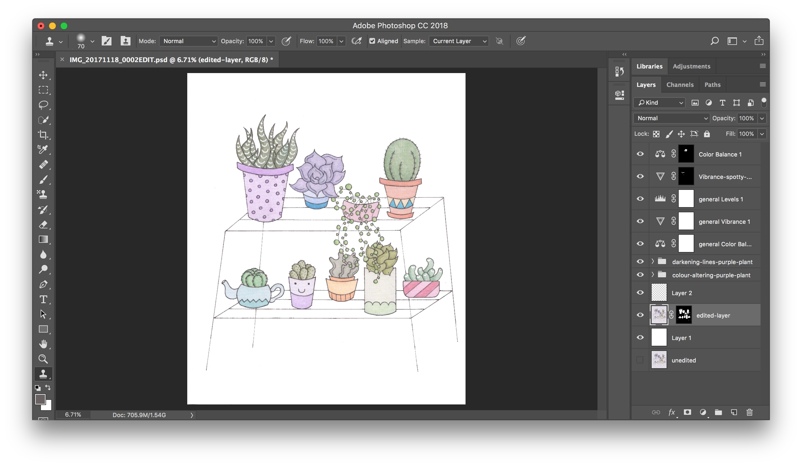

I've attached my screen, I'm positive that I'm on the right layer but I've just realised something most bizarre. The clone stamp is working on some parts of the image but not others even though I'm working on the same layer.
Norman Sanders
Norman SandersCorrect answer
November 27, 2017
From a view of the Layers panel, the Clone tool would not work in an area protected by the mask, only the area in the image shown on the mask in white..
