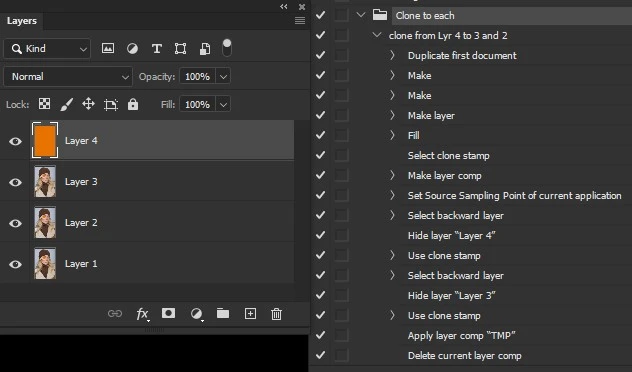

Zesty_wanderlust15A7
June 20, 2023
It does work, IMO.
This action is safe to run. It makes a dupe and makes some layers.
It takes a sample from the orange top layer and clones it to two layers below it (then restores initial view — "fancy stuff" that is not really needed. Hiding layers isn't either.).
It's just a proof of concept. Do it how you like.
I recorded this with the ruler set to percentage, which may be essential.
If you want a specific blend mode for the Clone Tool, maybe you need to record a Clone Tool Preset that you record when selecting it. I may have forgotten other things.
Oh, you need Tool Recording to be selected (if you can't, remove ScriptListener plugin).
As often when making actions, I discover bugs galore.
I initially had three layers to clone the sample into, but by the third layer the sample somehow got lost. I also saw weird stuff where my Clone tool disappeared behind parts of the picture somehow. OTOH, I'm not the most experienced guy with the Clone Tool...
Duh, I forget how you have to attach an action, and nothing is working. Forum suck is strong with this one... 😉
Visually, the example looks like this ...
