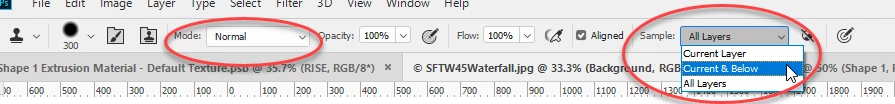

Hi Matthew
Check the options bar for :
a. The brush blending mode - try "normal" for most cloning
b. The sampling option - try "Current and below" for most cloning  - if set to all layers and there is an adjustment layer above the layer you are cloning from and to - then cloned part will have the adjustment applied twice
Dave
