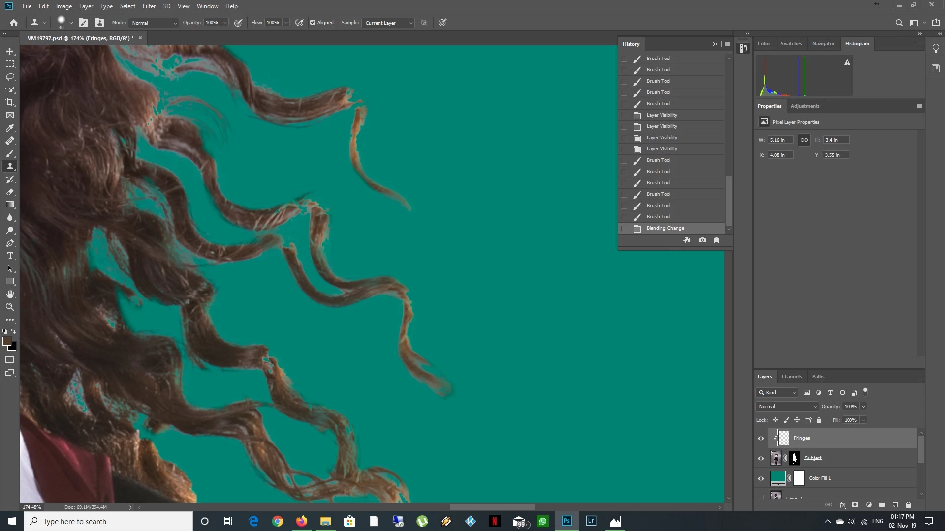

Correct answer vadimm888
Problem solved!!
While working on the clipped layer with the clone stamp I had tp choose from the tool's combo box (top section): "Sample: Current & Below" 🙂
The guy on the tutorial haven't mentioned it, but on other tutorial someone else did.
Many thanks everyone!

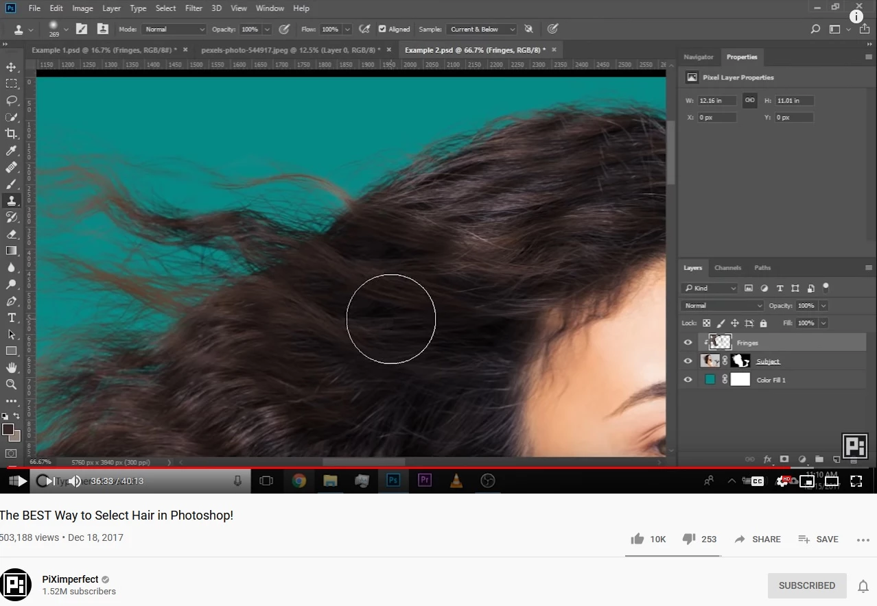

vadimm888Author
November 2, 2019
Thanks for the response,
I'm following the exact steps as in the tutorial...
He is taking samples while being ON the clipped layer, and the painting also on that same layer..
For me, I can't take a stamp sample while I'm on clipped layer, only on the original.
Check the attached screenshots, on from the youtube tutorial and the second from my workspace:
Hope you can see whatever you need.
Thanks for the help
