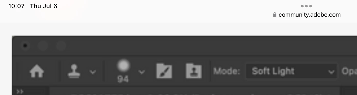

Hi, I am trying to work the clone stamp tool and its not working. I hold option and click on the area I want to clone, then drag my trackpad over where I want the cloned area and it doesn't do anything. I am cloning the background layer and have the clone option as current layer. All settings are as standard and when I have cloned I can see the preview but when I then drag onto the part I want to paste that, it just doesn't do it.

Hi Scarlett,
In the options bar, change the blending mode from Soft Light to Normal.
Jane

I had the same exact problem but the solution was to go to the options bar and change the Opacity to 100%.  Somehow mine had been changed to almost 0 %.
