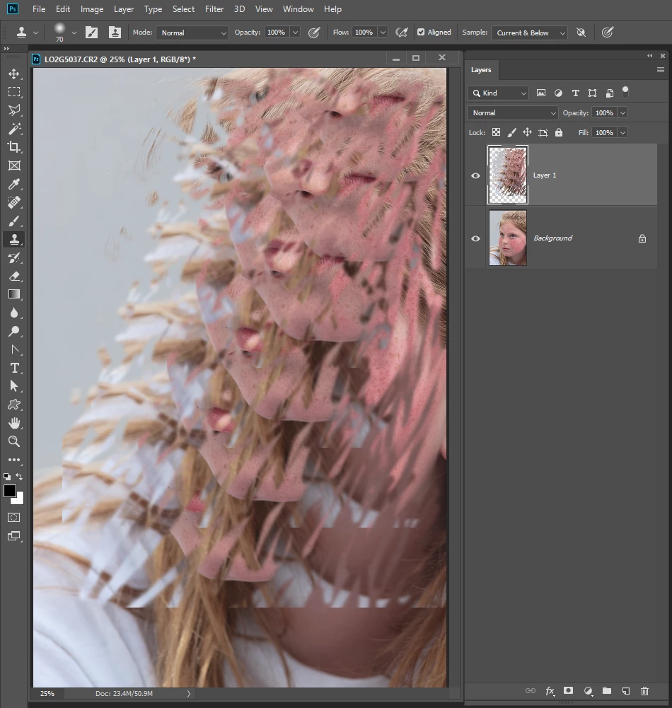

Hi, since I updated to the latest Photoshop version I'm experiencing an issue with the clone stamp tool whereby after a little while the cloning source is stuck to a certain area and can't clone unless I choose another area. Another error: sometime I get a straight line of cloning from source to cloned area as if I had drawn it. I'm using a Wacom tablet but I think the issue relies in the lates PS version infact if I use PS 2018 I have no problems at all.
Thank you !

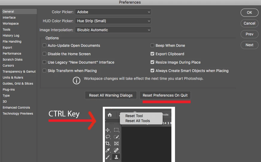

Correct answer mjbelt
Once you update you reinstall Wacom drivers, add a few more steps:
1. Reset All Tools (CTRL Key)
2. Reset Preferences
