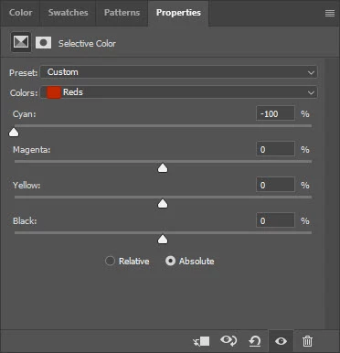

Bojan Živković11378569
May 28, 2020
What is not clear, how to use Selective Color adjustment?
Choose red, for example, from the Colors: drop-down list, then use slider to remove cyan. To remove cyan drag slider to the left.

D Fosse
May 28, 2020
Selective Color is designed to work this way, by removing or adding components. I usually prefer that over Hue/Sat, because it's less disruptive to image integrity.
If you stay in CMYK, watch your ink levels. As long as you remove C M or Y you should be fine, but if you start adding color components you need to watch out. The safe procedure is to do it in RGB and convert to final CMYK when done.
