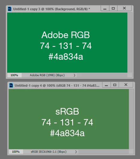

Hexadecimal numbers are not absolute, despite what most people think. They are just base 16 notation for standard RGB numbers.
Numbers are relative to color space.
This means that the same color will yield different numbers in different color spaces. And any given set of numbers will produce different colors. Note the hex numbers here:

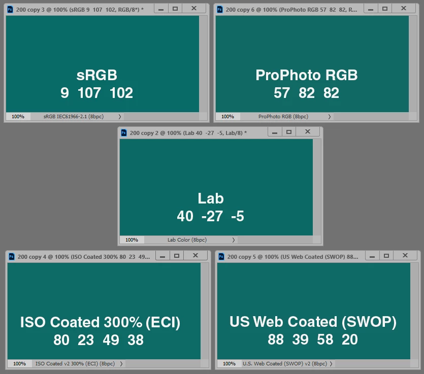

The same goes for CMYK. US Web Coated (SWOP) is not the same as, say, Coated FOGRA39. The numbers will be different.
So you always need to know which specific color space you are dealing with. There is no need to synchronise color settings in Bridge, but you need to keep track of the document color spaces and know what they are. If you want consistency, you can only get that within a certain color space.
If you want an absolute reference, use Lab numbers. That's the reference for all color management:
There is also the matter of gamut clipping, which can easily happen in RGB > CMYK because the latter usually has a much more restricted gamut. That's just the limitations of the inks used in offset printing.
