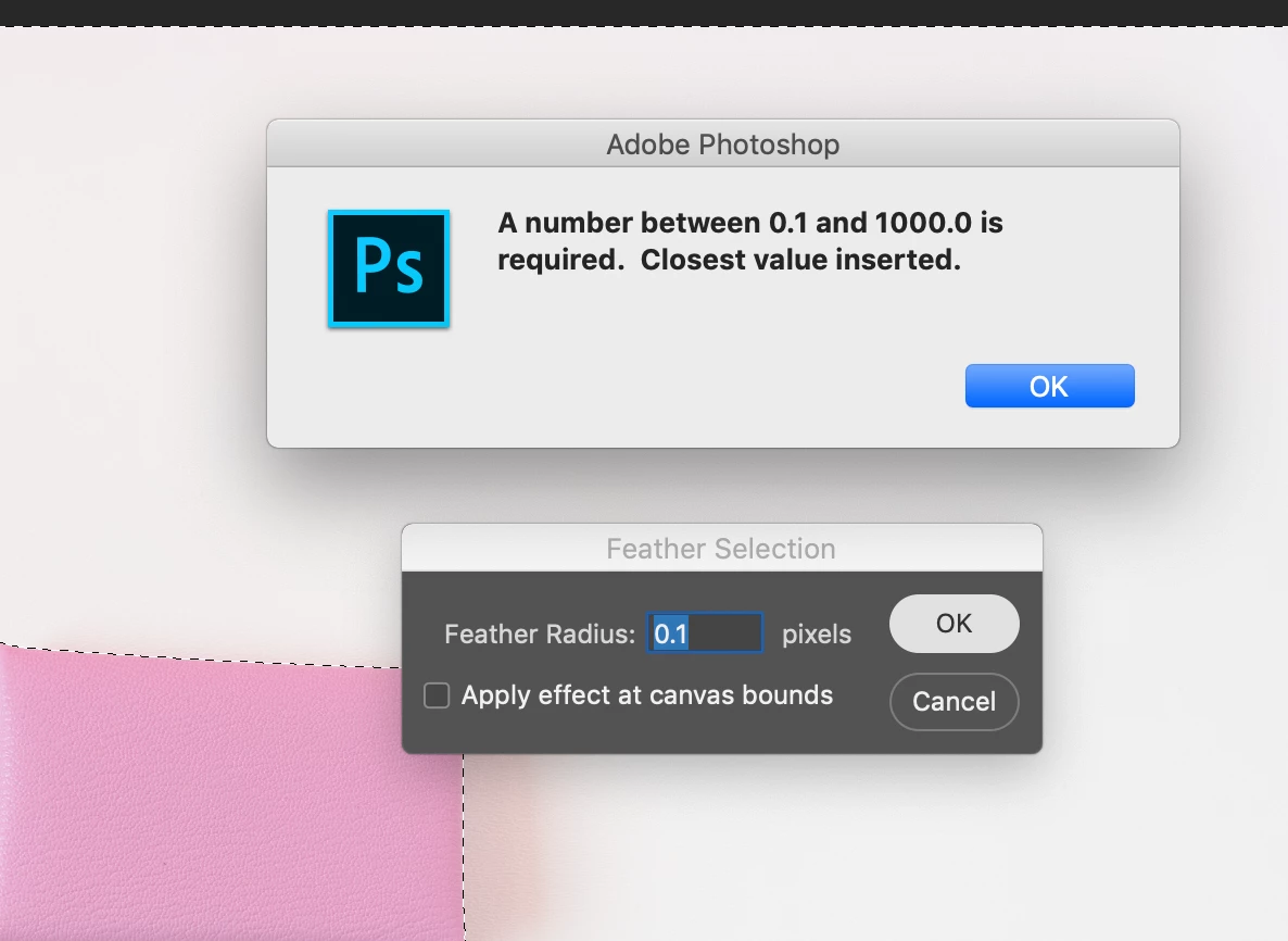

I tried to find an answer to this problem I have, but couldnt find it anywhere. I'm a beginner to photoshop. Can anyone help me with this? When I paint a color either inside or outside of a selection, theres always bleeding on the other side when I zoom in. Please see photo below. There's blue outside of my selection. Thank you!
    Correct answer Semaphoric
    It looks like you tried to change the feathering via Select > Modify > Feather. You need to set the feather to zero in the options, before y9u make the selection:

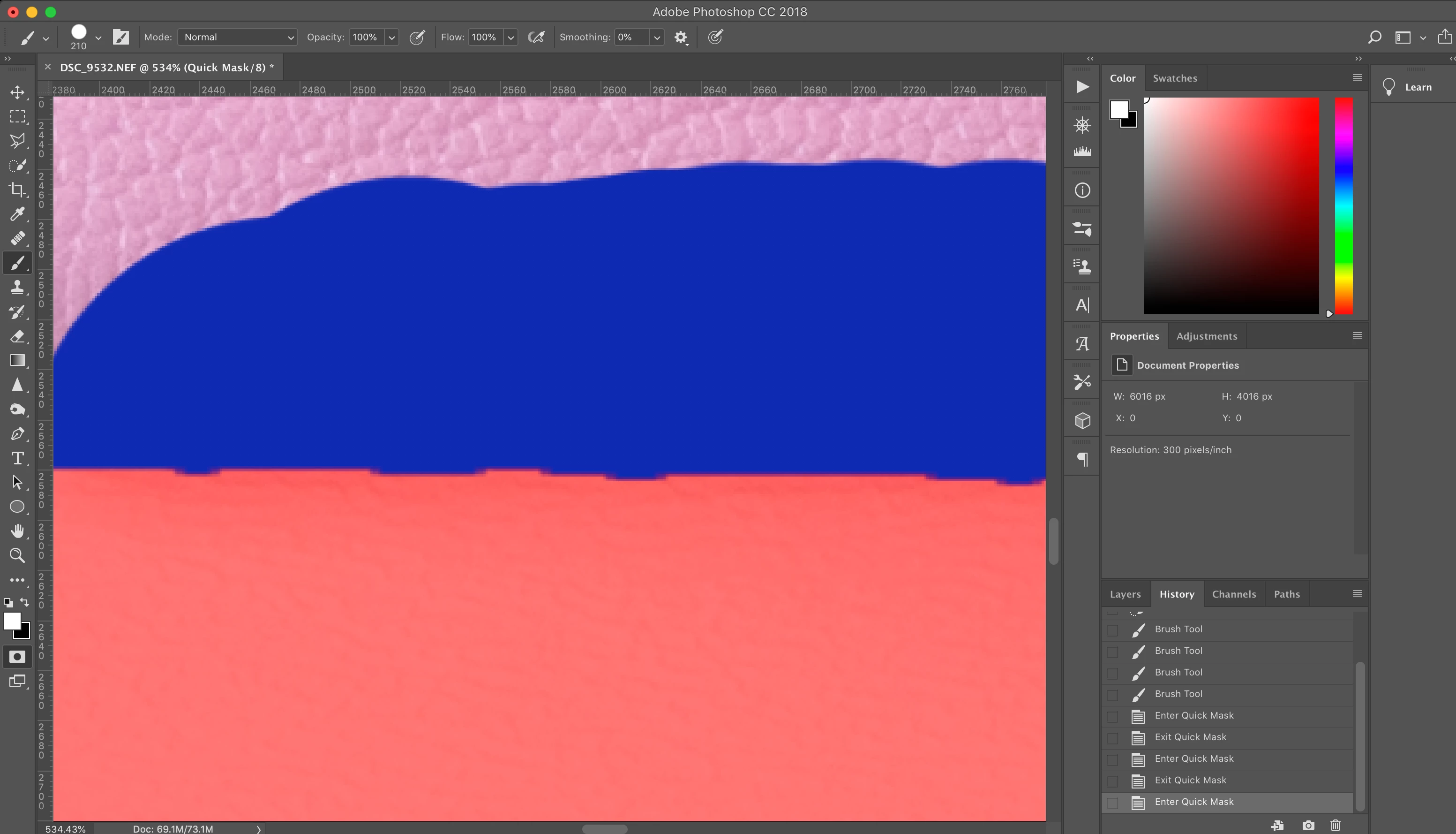

    susanz92477680
    July 28, 2019
    This is a screenshot with the quick mask mode. As far as i can see, the blue is still bleeding over than the intended selection.
    josephlavine
    July 28, 2019
    This is generally a "feather" issue as mentioned above,  Keep in mind that the selection/marching ants show without feathering and feathering extend both inside and out of the selected area.

    mglush
    July 28, 2019
    Hi!
    We are happy to help! When you create a selection, do you have a value in the feather field in the Options bar? This would account for a any type of bleed outside of your selection.
    With whatever Selection tool you were working with active, check the options bar and make sure that the Feather Option is set to 0.
    If the Feather is already set to 0, then please show us a screenshot of your workspace with the image open so we can take a look.
    Thanks!
    Michelle

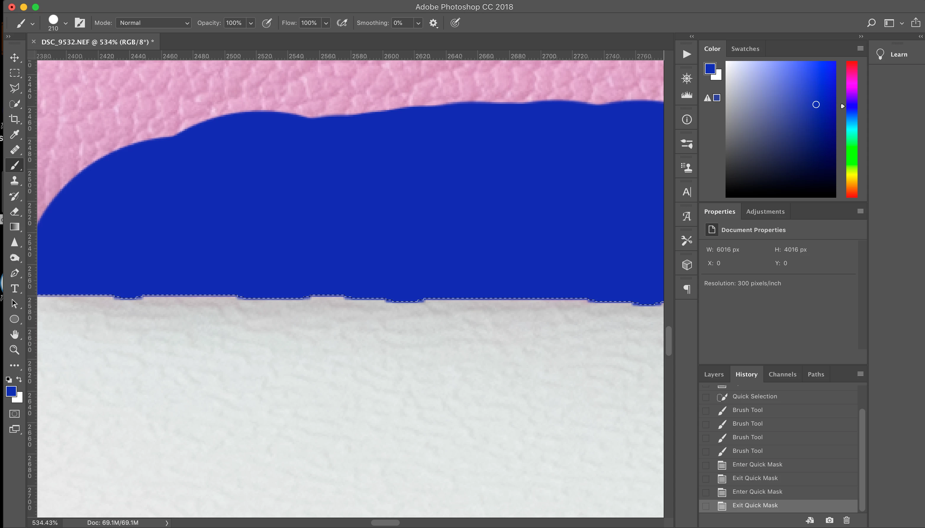

    susanz92477680
    July 28, 2019
    Thank you for your response! The feather has to be set at at least 0.1 pixels. But it didnt make a difference whether I set it at 2 or 0.1
    This is a sceenshot of the work place. I use the color blue, so it will be more obvious to see.
    Semaphoric
    SemaphoricCommunity ExpertCorrect answer
    July 28, 2019
