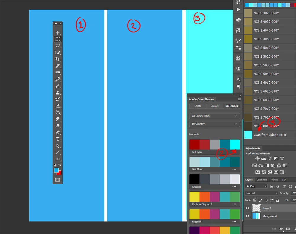

When I make a color theme in Adobe Color CC and then opens it in Photoshop CC. It changes its visual apperance, in some colors alot and others less and even CMYK/RGB code changes depending from where i select the color. why is that?
Let´s take CYAN as an example, on this color this is probably most apperant. (See picture and following text)
1: The color CYAN selected in photoshop. (100,0,0,0)
2: the color cyan from adobe color. selected thru the Adobe color themes panel. The visual of the color on the panel is very different but the result is the same when applied (100,0,0,0)
3: The color CYAN is added to the swatches panel from adobe color themes panel. And then applied. In this case the "CYAN" color turns in to (46,0,11,0)
Can anyone help me explain what is happening and why?
Why does the colors in Adobe Color CC look so different from Photoshop and why does it change in Phooshop depending on how i apply it???
The same phenomenon occurs in both RGB and CMYK mode. I´m running a windows computer and haven´t seen any differences in Chrome and Explorer on how Adobe Color shows the colors. I have monitors callibrated regularly a Eizo and Wacom zintiq. So I am pretty sure that the screens does'nt  play me any tricks.

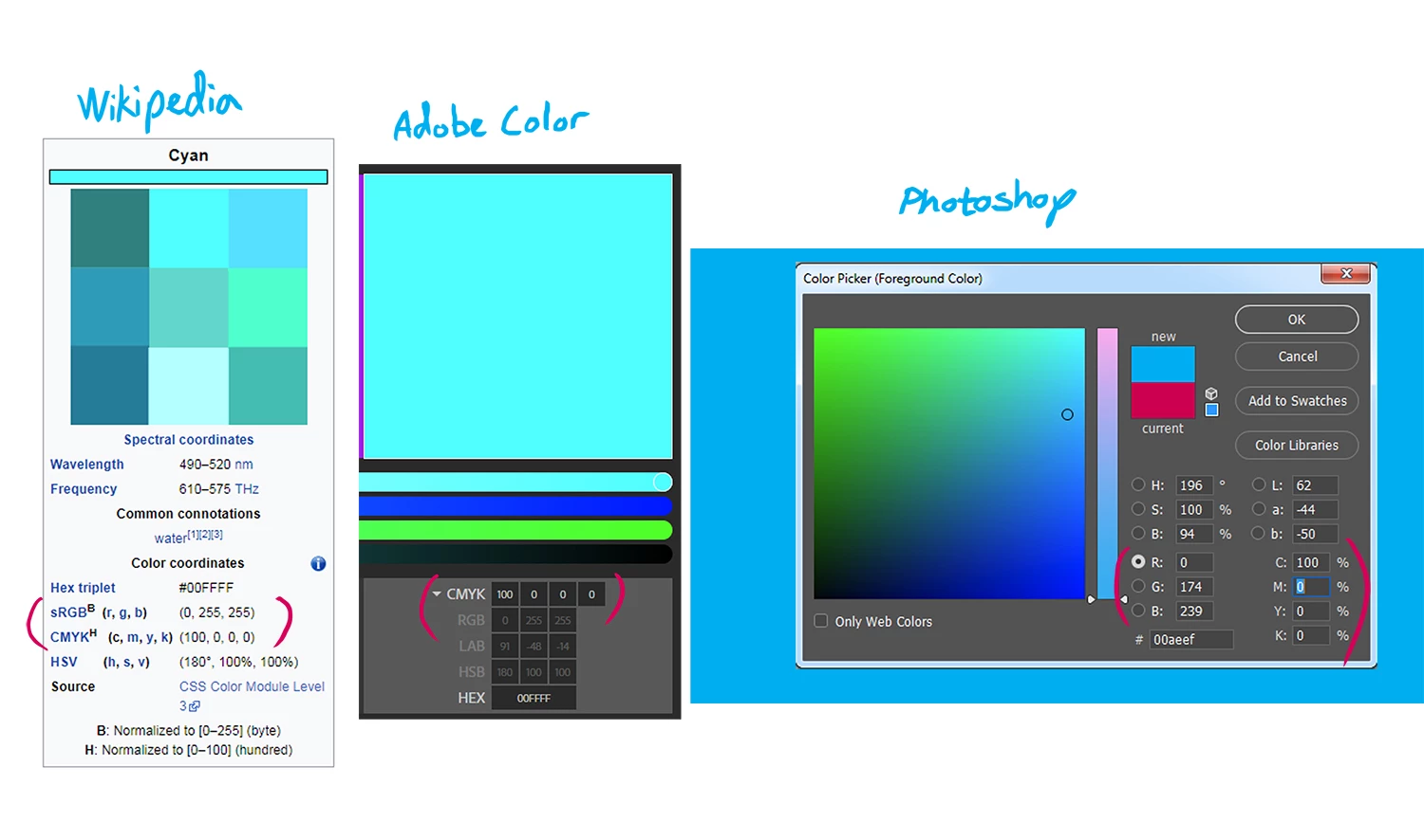

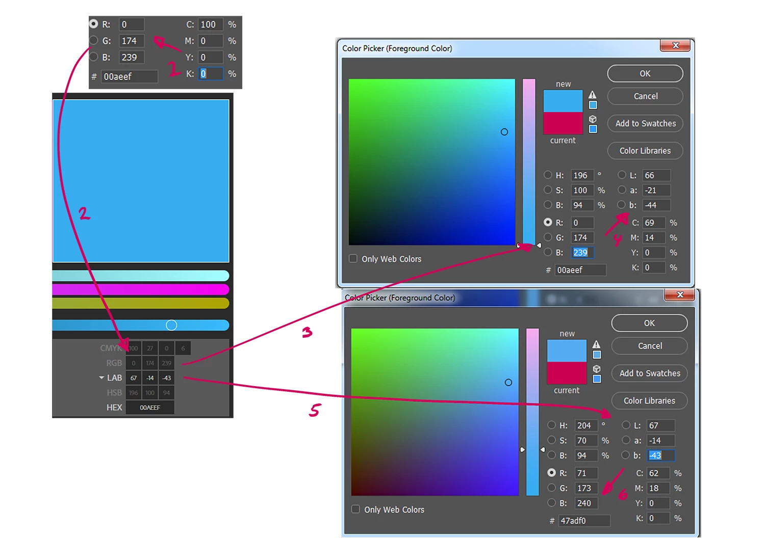

I did a couple of tests myself, maybe you can help me to interpret them.
Test 1: Performed in Photoshop CC (sRGB working space) and adobe color CC
1. the cmyk values for cyan in photoshop (original lab values i got here was 62,-44,-50)
2. took the rgb values for cyan that photoshop gave me and put them into adobe color.
3,4. then the rgb values back to photoshop and looked at the lab values I got back.
5,6. then i did the same but the other way around. LAB values from adobe color back to photoshop.
What does this tell me.? Values change a bit, yes, but is this in proportion what i should expect? Visually the colors look close to the same. Cmyk values are way of all the time, stay away from them.
Test 2: I did exactly the same with a handfull of other random selected colors. And the pattern repeats itself. Sometime its closer in values sometime a little bit more apart. And it varies from close to quite far apart on how they compare visually.
Test/Reflection 3:
I started to think about the values and colors that "cyan" gives me. And I did a comparison also there.
First what does wikipedia say about cyan. ( I have also read in many places on the internet that cmyk 100,0,0,0 is absolutely not rgb 0,255,255). If wikipedia is a good source or not we could leave out for now. Adobe color however fully agree with wikipedia on both color codes and color visually. But photoshop shows me something completely different. Both in rgb code and color visually.
Could  anyone please explain this to me??! right now I am feeling really confused again......

I have Adobe Color CC (color.adobe.com) open in Firefox as I write this - and this is, frankly, ridiculous.
In Photoshop, I'm punching in a cyan color in sRGB, 25,155, 245. That particular color is well within sRGB gamut, so no surprises. Or so I thought.
In Lab, this color is 61, -8, -55. That's an absolute color reference.
So I go to Adobe Color and put in those Lab numbers. In the RGB readout it now says...0, 157, 245. What's this??? It's not sRGB, it's not Adobe RGB, it's not even Monitor RGB. This is the difference:
It's fine that they give a Lab readout. But giving RGB and CMYK numbers without a specific reference to which RGB or CMYK color space - that's just...nonsense. One could assume sRGB, which is the defacto default if no color space is given - but it's not even accurate at that!
Bottom line - these appear to be just random numbers without any real-world reference. This is completely useless.
Oh, BTW - assuming this actually worked, CMYK numbers would be whatever you have set as working CMYK. If you haven't changed anything, that's US Web Coated (SWOP), which only has limited use in North/South America, and not at all elsewhere.
