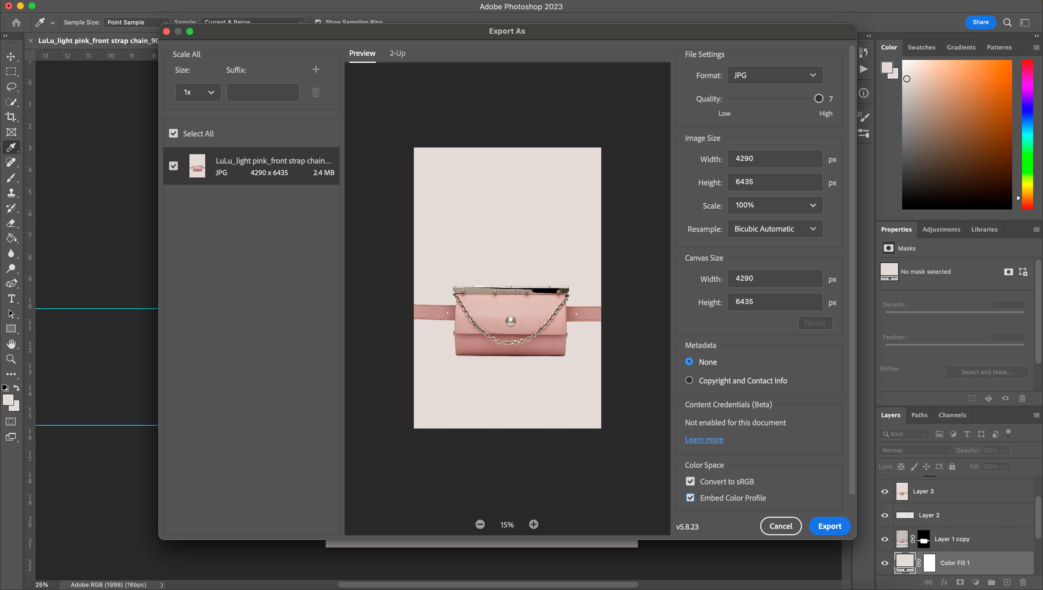

I export the images prety simple. I just do file>export as> jpeg highest quality on the slider.

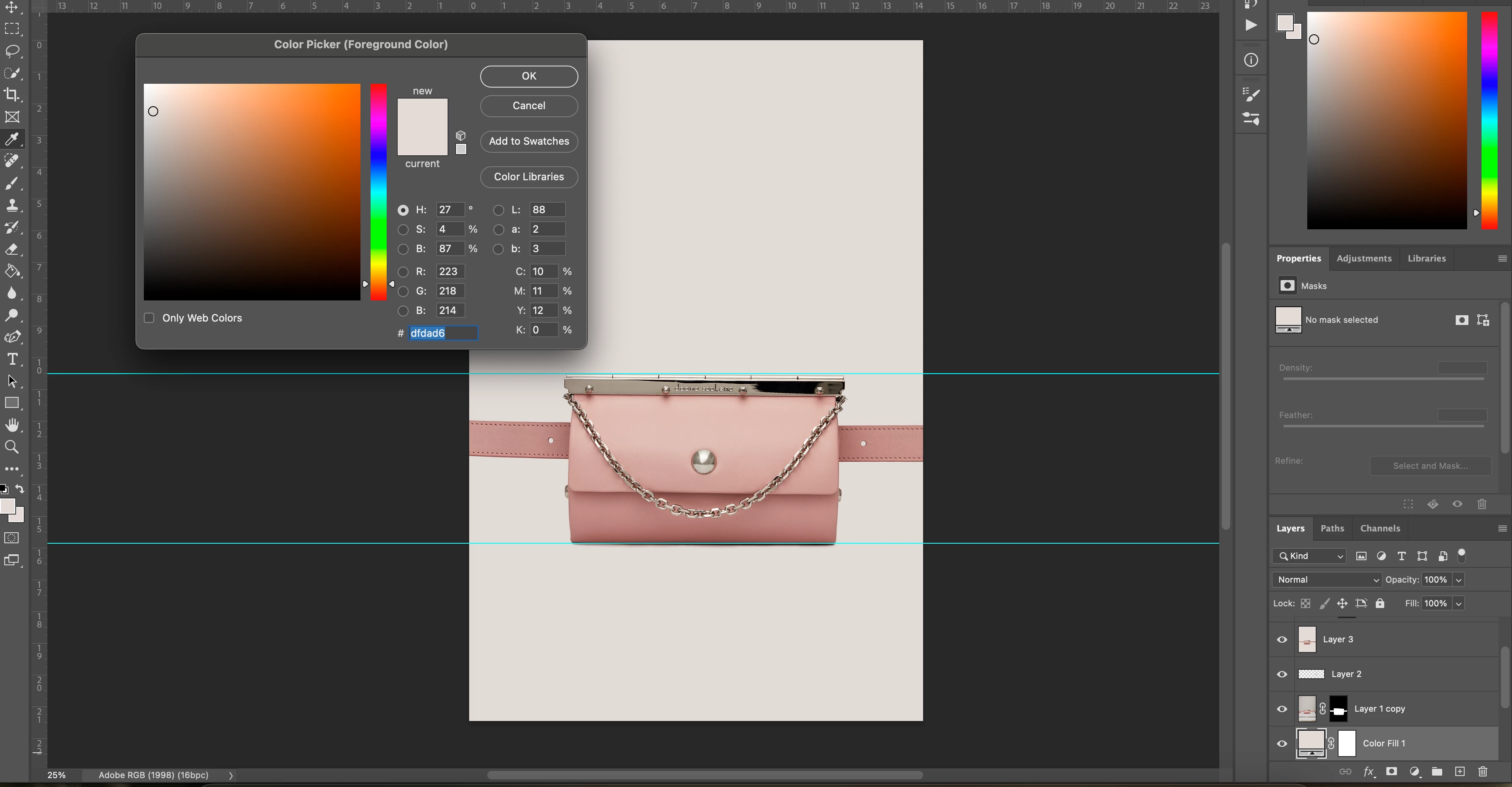

first image is the original working file .psd color is all correct. background it set to DFDAD6

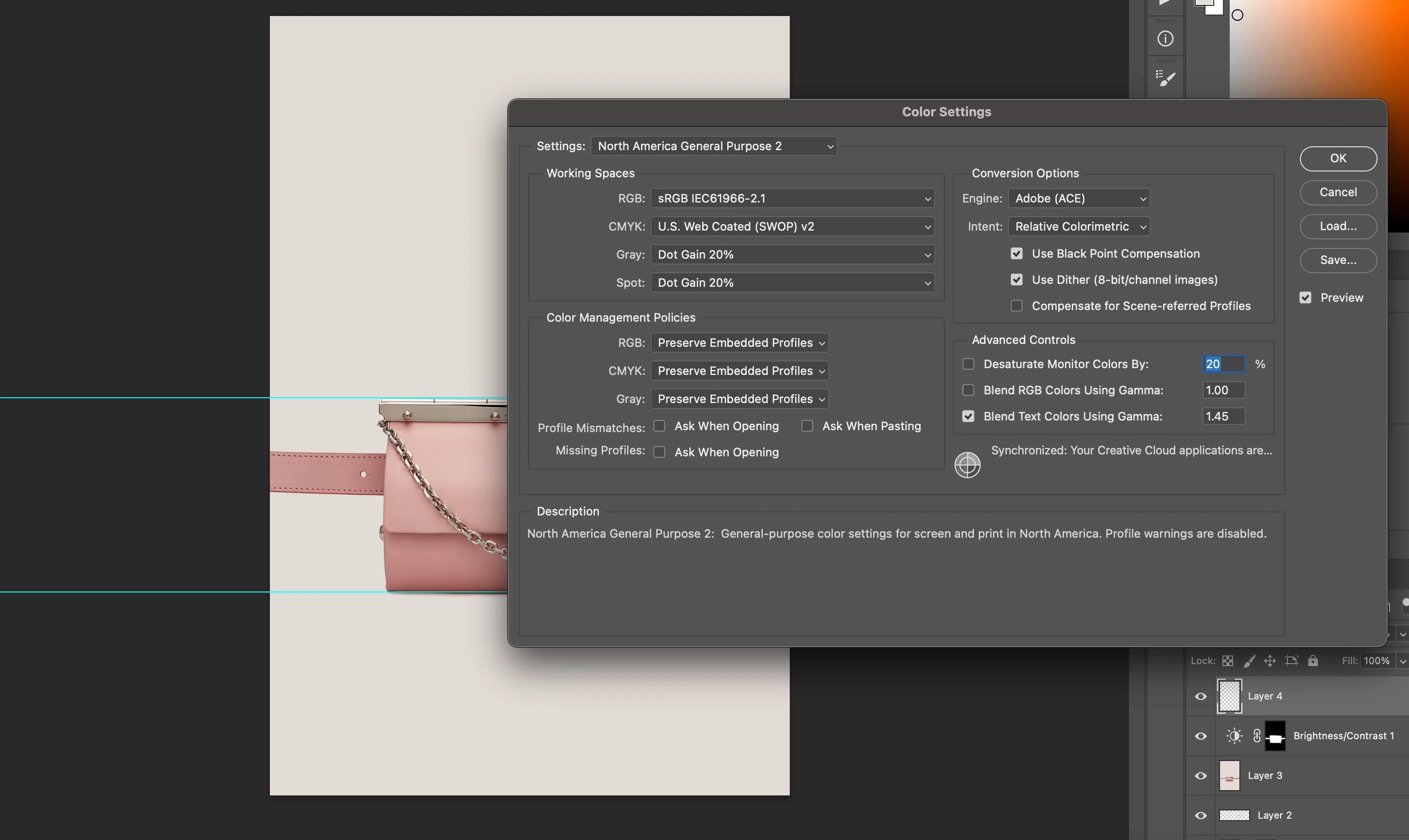

second image is export screen exactly how I export. never had an issue with other images in the exact format but now after exporting some images are affected

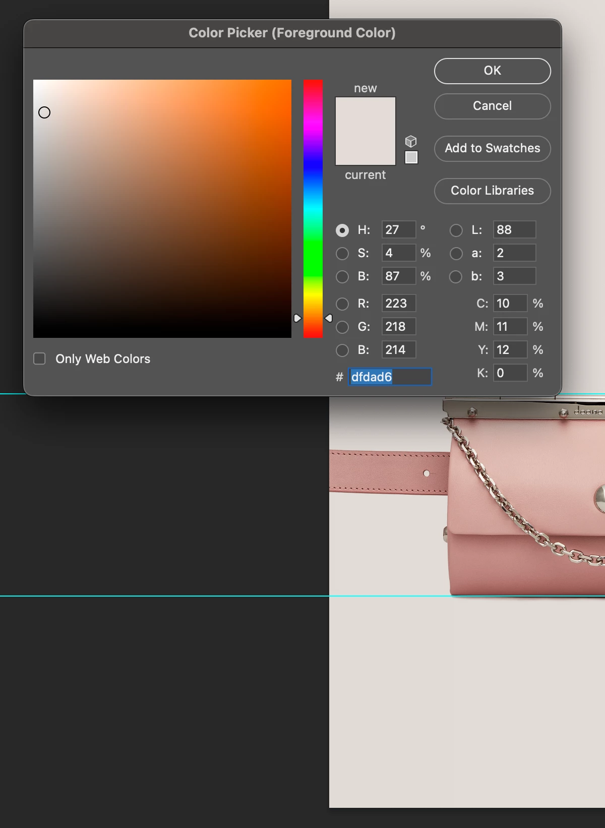

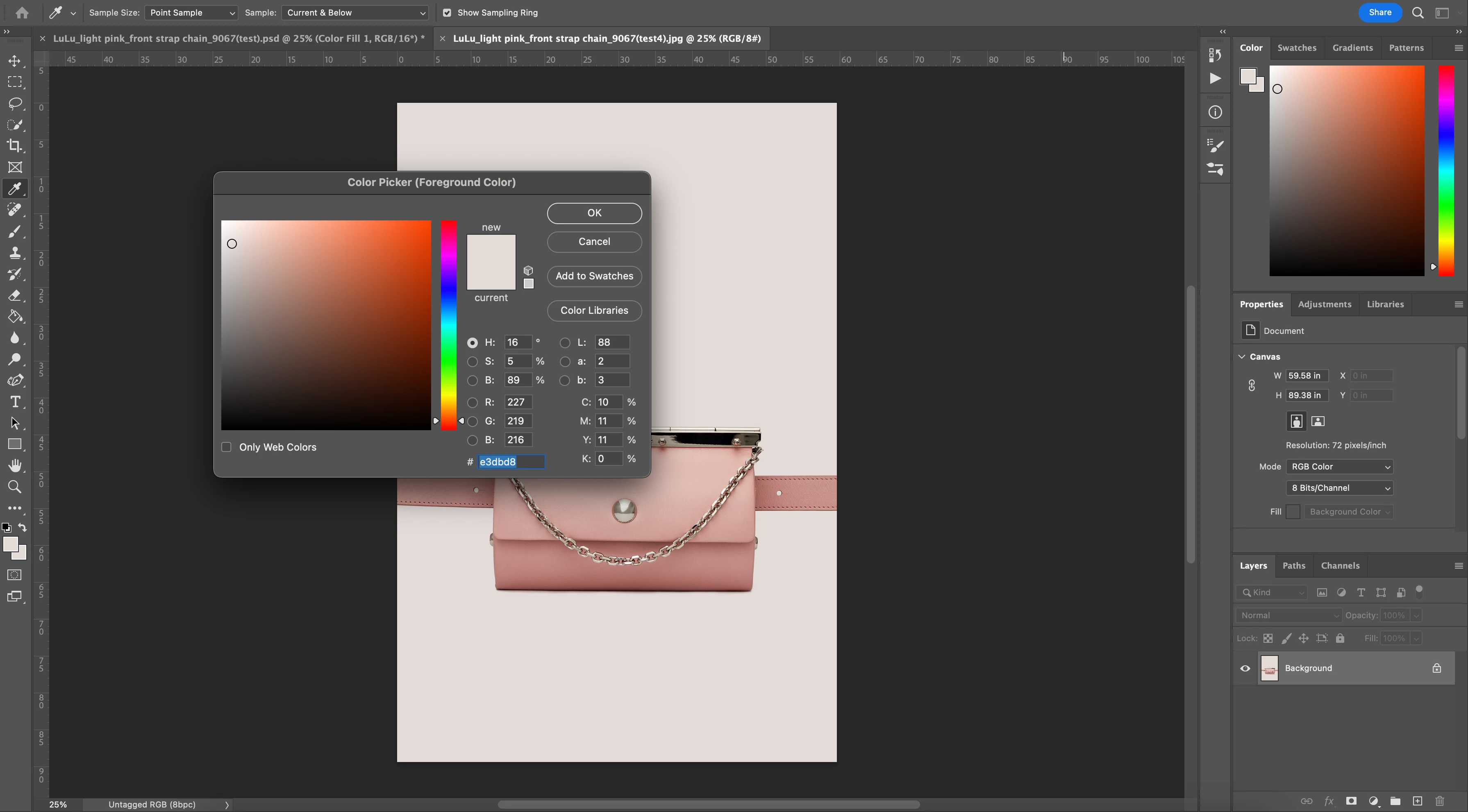

thirst imag is the jpeg from exporting and the background color shift.

There are several things that don't add up from the screenshots that you show.
1. Your 'before exporting' screenshot shows a document in the Adobe RGB color space. That is different to your default color space which is not in itself an issue, but it is if your are using Hex colours that have been referenced to sRGB.
2. Your second screenshot looks OK and shows the document will be converted to sRGB on export and the Color Profile for sRGB will be embedded in the document.

3. Your third image shows that your re-opened document is untagged (i.e. has no embedded profile). In this case your default profile of sRGB will be applied. However, your export settings show that the profile should be embedded. Can you check again you have used the actual exported image.
As for the color change - there is no color change. The same color in two different colour spaces is represented by different RGB values (hex numbers are just RGB values to base 16). Similarly, the same RGB (orHex) values in different colour spaces represent different colours. So what you are actually seeing is the values converted from one colour space to another, allowing for small rounding error, both representing the same color.
If you have been asked to use specific hex values, then unless it is stated that those values are referenced to Adobe RGB, then use sRGB. This reference should always be stated when RGB colour values, hex or otherwise, are quoted but rarely is. Without that reference to you may as well just say light beige.
