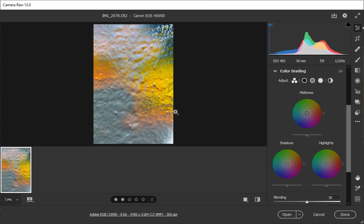

I watched a tutorial by Denny and he has a color picking option box with his color wheel why don't I have that?
Correct answer davescm
It should appear in Lightroom as long as you have one of the the large colour wheels selected. It is hidden when you have the three together shown.
Dave

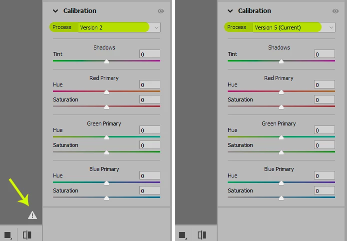

...and also, it has to be Process Version 5 for the color grading tool to be an option.
If it's previously edited using a different process version, update here:
davescm

The video is showing Lightroom not camera raw
Dave

Thank you for replying Dave, I have the same issue in lightroom.
Dave

timmunseyAuthor
October 31, 2020
Hi Bojan thank you for looking into this.
On this video at 6.06 you can see he uses a picker I don't have this option:-
https://www.youtube.com/watch?v=2HzUXR8V-Qo&feature=emb_logo
Tim
