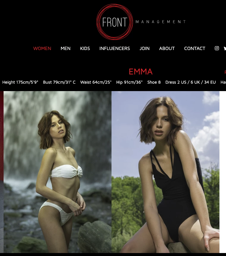

Hello everyone. I am posting this trying to find a solution to an ongoing problem I have been noticing in the hopes that someone else has experienced and solved this, or perhaps is armed with technical knowledge that I do not have.
I am a fashion photographer that shoots tests with agency models. I shoot and edit the images and send them to models and their agents. Often the agents update the models online portfolio with my images. In several cases I have noticed a dramatic inconsistency between the colours I am seeing and the colours that show up on their websites.
Now to be clear, I don't believe this is on my end. My colours are consistent between all my devices with the subtle variations that exist between screen types and settings. I also have confirmed this on other peoples iphones and devices and my editing monitor though aged, is calibrated using a spyder. It just seems that certain agencies websites are displaying/rendering the images incorrectly. I share the images via dropbox folders always and have confirmed that dropbox is in no way altering them.
What I'm trying to determine is, what is happening after I send these images out to these agencies that is causing this? Could it be something happening in the upload process of the websites themselves? Are the sites possibly using some sort of images compression that is altering the color settings?
I have attached a sample to this message. A screengrab from one of the websites, and small versions of the two edits as they should appear. Any input on this issue is appreciated.
Thank you in advance!
Correct answer D Fosse
  • Convert to sRGB
  • Embed the color profile (sRGB)
  • Done
That covers most real life scenarios. Anyone using a properly color managed web browser will then see them correctly (or as close as their displays are calibrated).
Most problems happen because the profile is not embedded. Make sure to check the box. Unfortunately, a lot of websites strip the profile even when it's there to begin with.
But even that isn't the big problem it used to be. All major web browsers today will treat untagged material as sRGB, and color manage based on that.
Phones, however, is a different story. Most of them have half-way generic color management, but not the degree of accuracy you now have with computer displays.

D Fosse
D FosseCommunity ExpertCorrect answer
June 3, 2022
  • Convert to sRGB
  • Done
KyleAndrew
June 7, 2022
I just wanted to circle back to this as I was waiting for something to occur on my end. I have verified that the response posted below corrected the problem immediatley. I was not exporting with these options checked. I re-exported, re-sent the images and had the agencies re upload the new versions and the colors are now displaying correctly.
Thank you very much, all of you, for contributing!
