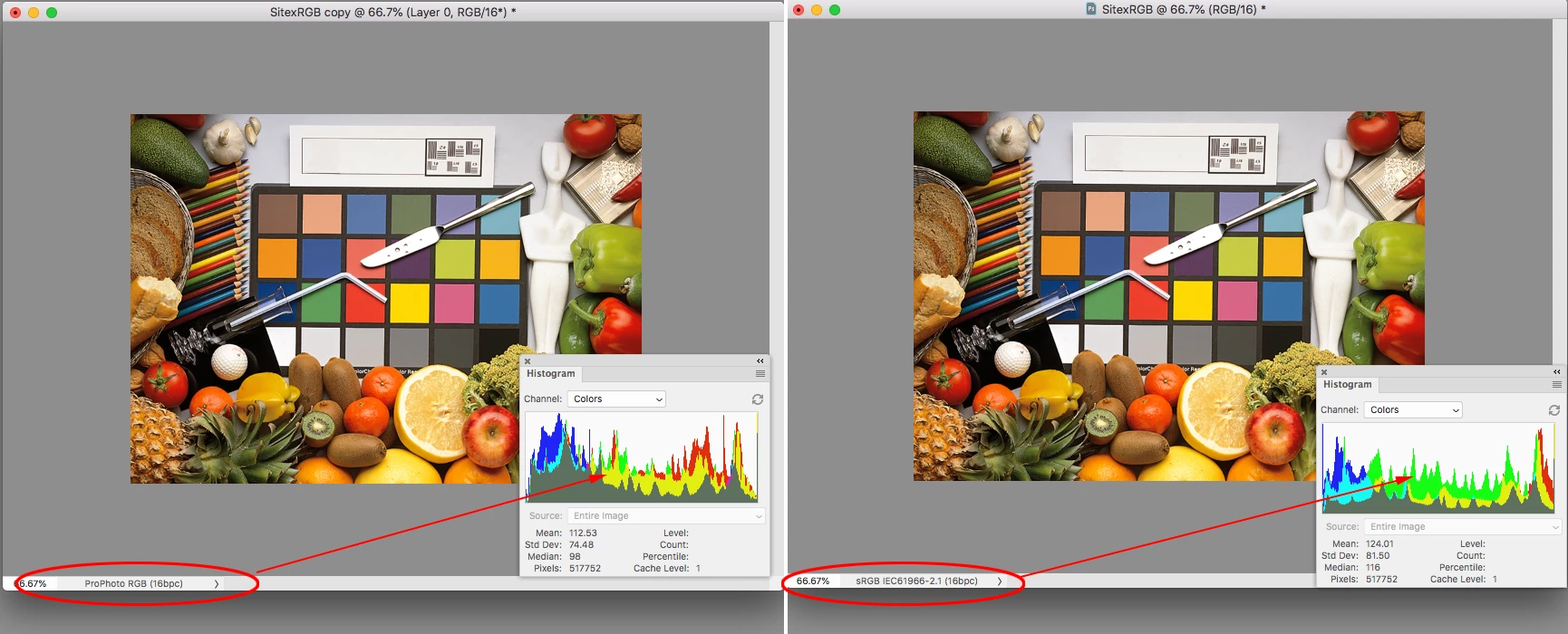

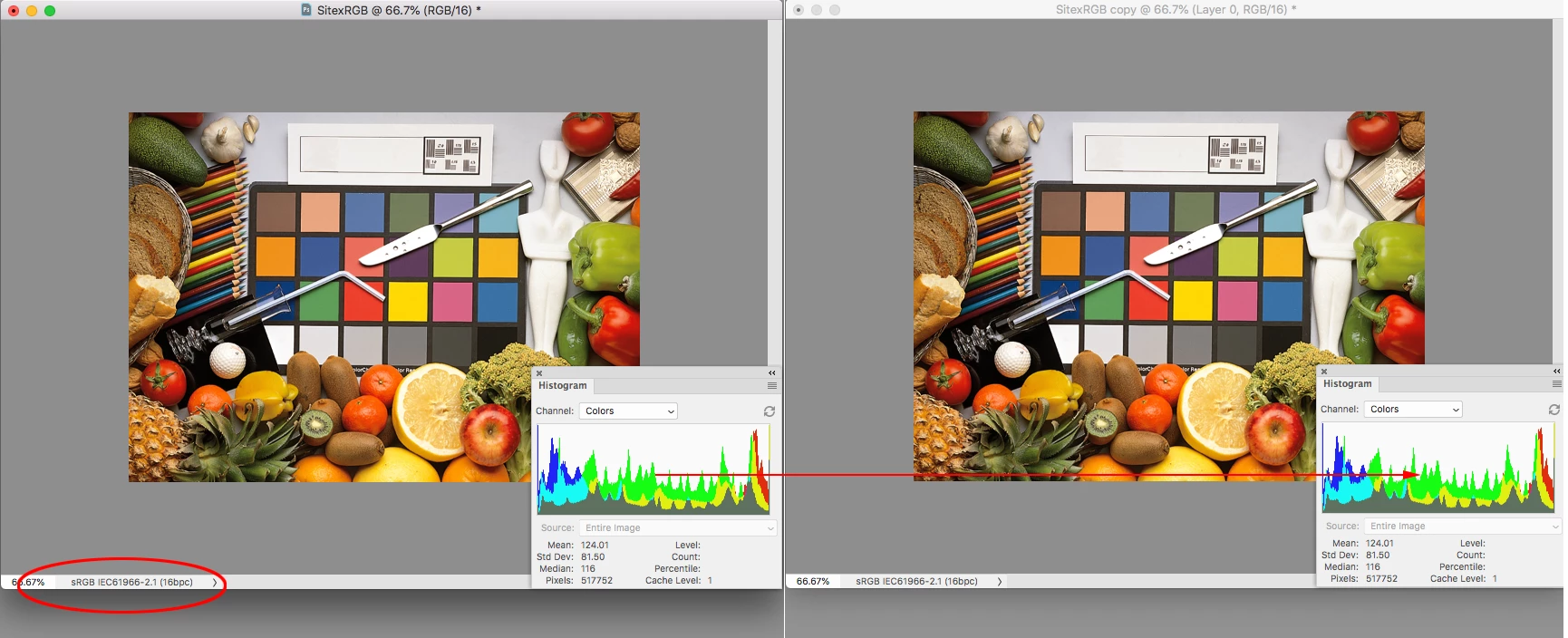

A ProPhoto image could have the same appearance as an sRGB image. Here the image on the left was converted to ProPhoto from the sRGB image on the right. As expected they have different histograms despite the same appearance
If the ProPhoto image gets converted back to sRGB the histograms are identical, so there would be no color advantage in working in ProPhoto when the destination is sRGB. If you are worried about gray levels then it’s the bit depth that matters not the larger space:
