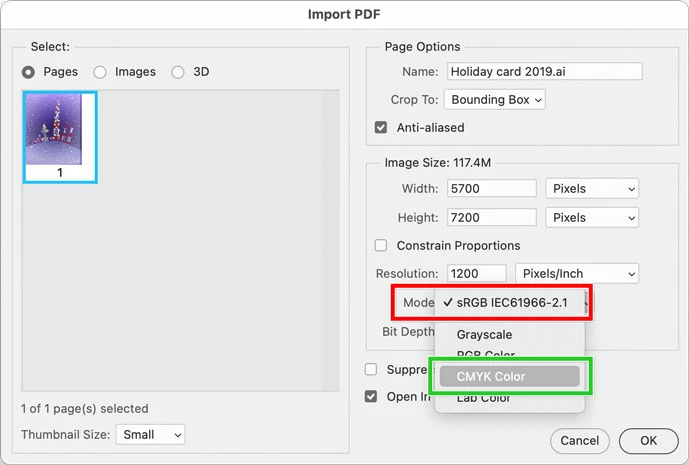

When opening an Illustrator file in Photoshop, the Import PDF dialog box opens, as shown in the picture below. It says Import PDF because the Illustrator file format is based on Adobe PDF.
The Mode menu sets the color mode of the converted file, so it’s important for whoever is opening the AI file in Photoshop to pay attention to the Mode menu when converting. In the example above, sRGB is currently checked (red) because the Illustrator file’s color mode is RGB. CMYK is being selected (green) to make sure that will be the color mode of the converted file. When I tested this, if the Illustrator file is CMYK, that Mode menu defaults to CMYK. So if they open your Illustrator file and that Mode menu comes up RGB, that means that Illustrator document was actually saved in RGB color mode.
It’s also important to note that Photoshop converts the Illustrator file to CMYK specifically using the CMYK profile currently selected in Edit > Color Settings. Whoever is doing the conversion should make sure that in advance, in Photoshop Color Settings, the CMYK working space profile is set to use the ICC profile that represents the printing conditions of their press.
If they don’t do that, then for example if Photoshop Color Settings is currently set to a CMYK profile such as U.S. Web Coated SWOP, and their printer is using a press setup that is nothing like that, then Photoshop will be applying an incorrect CMYK conversion.

I also tested (see attached screen recording) and even though my file was in CMYK color mode in Illustrator, the mode is defaulting to RGB in Photoshop.
Bojan Živković11378569
July 20, 2022
In Photoshop check what is set in Color Settings > Color Managament Policies > CMYK. When turned Off it is defaulting to RGB from my testing.
