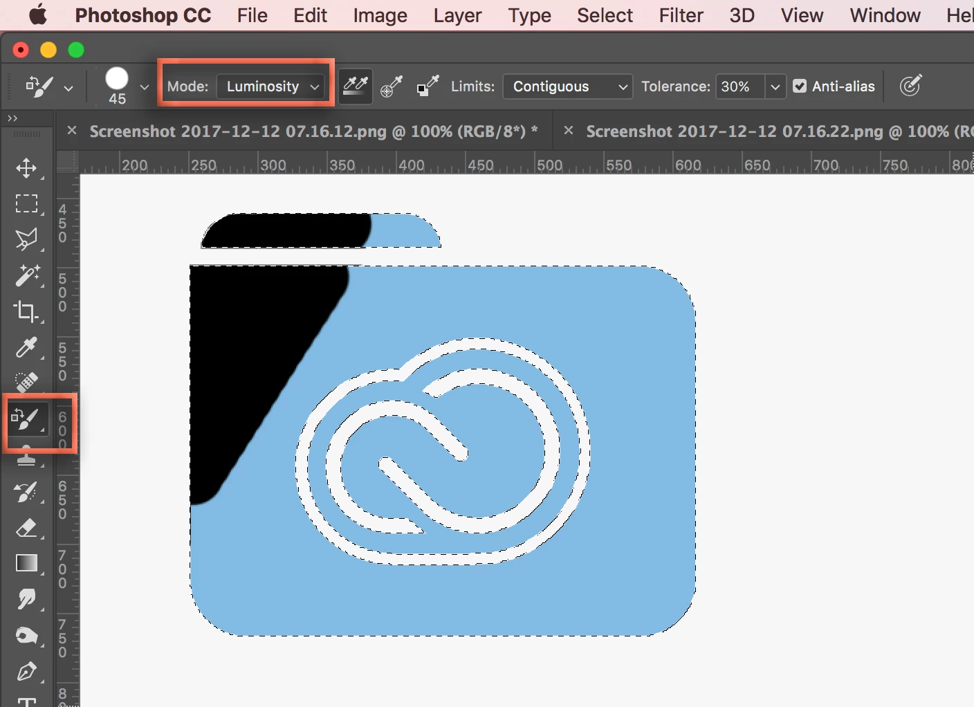

Hello All,
Im using PS CC and am trying to change the color of an icon from blue to black.
I tried using the color replacement tool and even though black is selected, the area changed to gray.  When I use the selection tool and the "fill"command both "fill black" and "fill foreground color" they both change to gray instead of black.
If I try another color-- (I tried Red)  the color replacement tool and the fill tool turned them to a salmon color.
I thought maybe I was in RGB settings instead of CMYK but I checked color mode and I'm in CMYK
Any thoughts on how to fix this?
Thank you!
Correct answer Barb Binder
Set the blend mode to Luminosity.

Barb BinderCommunity ExpertCorrect answer
December 12, 2017
MBoruckiAuthor
December 12, 2017
Thank you Barb! This did the trick!
