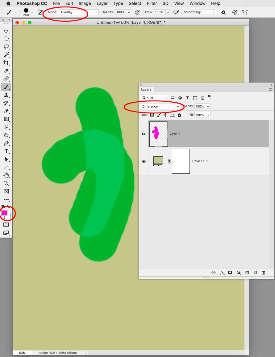

So what's the deal? How can I get this fixed? Whites are yellows, and out of every blue, red, green etc I pick it can only draw like 3 color variations out of them even though I have an entirely different color picked.
You could have a color managment problem, but it sounds more like a Blending Mode issue. Could you be working on a Layer where the Blend Mode is not set to Normal? The brushes also can be set to different blend Modes—here I’ve picked a magenta hue, but the layer is set to Difference. Maybe you could post some screen captures?
