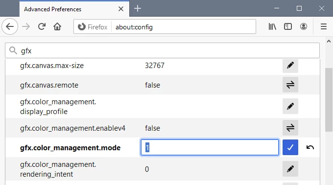

I don't use any of the websites you're uploading to, but most likely, they are stripping out the sRGB profile, causing the over saturation in Firefox.
Safari and Chrome automatically assign sRGB to untagged material, but Firefox doesn't do this by default.
To fix this, set Color management mode in Firefox to 1.
Type about:config in the address field, and press Enter.
Type gfx in the search field, then scroll down to gfx.color_management.mode.
Change 2 to 1, press Enter to confirm, then restart Firefox.
It should now display correct colors.
