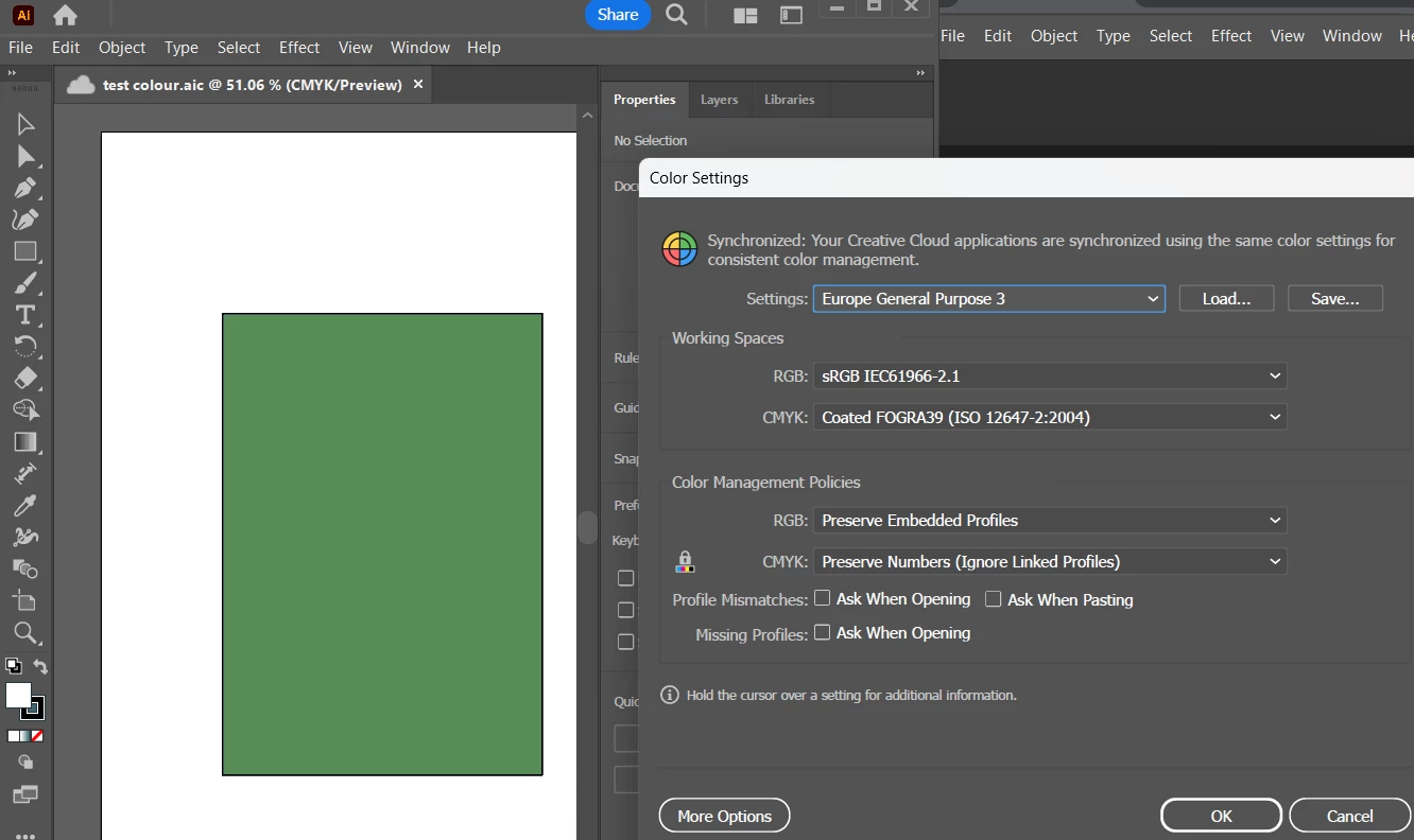

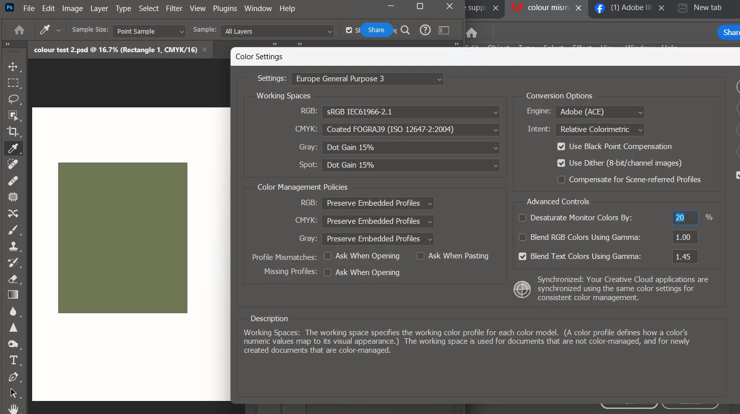

Can anybody help me achieve a colour match between Photoshop & Illustrator please? I have synced colour settings via Bridge, checked matching colour profiles in both programmes, checking both using CYMK and used the same colour hexcode. The colours are still miles apart. Please see attached screenshot for reference. Any help would be appreciated!

Can you provide the two files? (edited)
D Fosse
July 28, 2024
Is there an embedded document profile in both and which is it?
July 28, 2024
Would you be able to tell me how to check that? Both of these documents
were just created as brand new test files rather than importing any
embedded graphics so they shouldn’t be affected by any embedded profiles
should they? I’m a novice so I’m not sure! I’ve always had this issue with
illustrator / photoshop. Incidentally, the colours in photoshop match
perfectly when I convert an illustrator file to PDF. So I’m assuming the
issue lies with illustrator somehow?
D Fosse
July 28, 2024
Ahh yes, the colour profile in both programmes is set to Coated FOGRA39 (ISO 12647-2:2004). It even tells me that my Adobe programmes are colour synced in Bridge. I appreciate your help!
Your color settings aren't relevant. They are just defaults for new documents and missing profiles.
  • Is there an embedded color profile in each document? The embedded profile overrides your working space. There has to be an embedded profile to define the color.
See my screenshot again.
