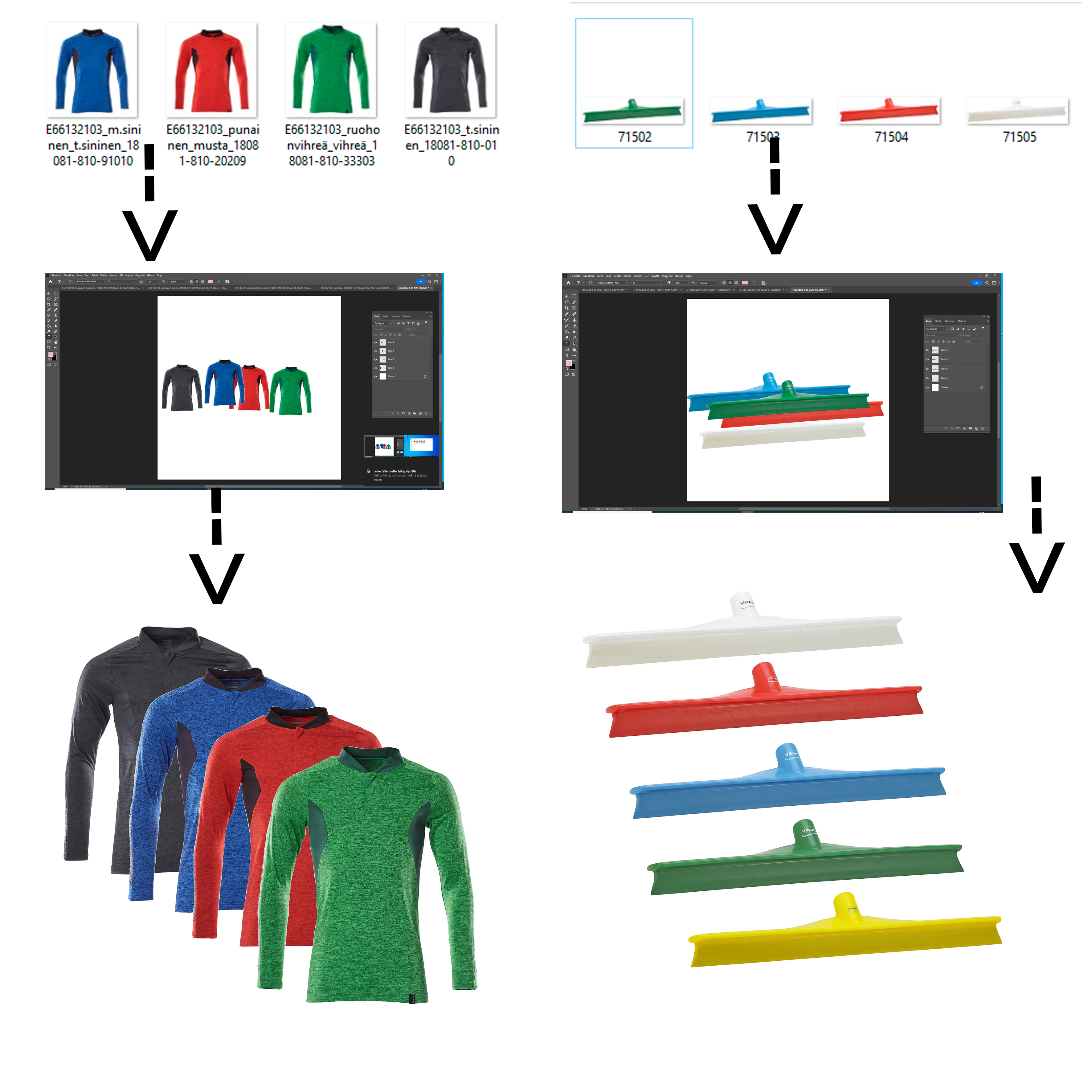

I am working on over a 100 000 pictures and i need to combine them into combined picture with 2-5 of the same product as shown below. The  instruction is to combine them into a canvas of 30cm X 30cm 300px per square inch. However all of the pictures are different shapes and sizes and i am hoping to use a batch/action to free time from combining them manually. I have tried some sorts of actions but i am not very skilled with photoshop. I was wondering if someone has a solution to this?  i will also link the individual products if someone wants to try it with the products below.
It would really help me with my workload!

I do like this:
Sort the images by the number of views.
Since you have a limited number of views (2-5), it will not be difficult to write a separate action for each number of images (I noticed that your T-shirts are of different sizes, so before I execute the standard fit image script, I crop the image object size) Using Advanced batch script, I would run pre-sorted images with the desired action.

June 30, 2022
This really helped. What have you done to the individual pictures to make them look like that and be able to use the distribute action to a single layer?
June 30, 2022
I simply created layer masks (using the select -> subject menu item). You wrote that you have paths on parts of images - you can use them to create a mask.
did you batch the masking process? Also can i save as jpeg when the picture is masked

Also there are premade paths on the individual pictures that i get if that matters.
