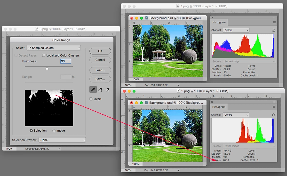

Norman Sanders
July 22, 2019
Note the difference in pixel count. Convert to percent.
Click on image for larger view

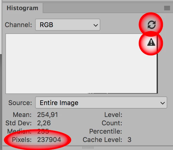

Hmm, the issue does not seem extremely clear I guess.
I wonder if the outlined process will really serve your needs.
If you want to determine the number of pixels of a Selection (ideally one without anti-aliasing etc.) you can check »Pixels« in the Histogram Panel (but refresh if possible!).
The percentage can then be calculated against the total number of pixels (width times height in pixels).
Instead of calculating that manually I expect one could automate the calculation with a Script, if it’s worth the trouble.
