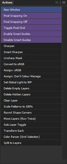

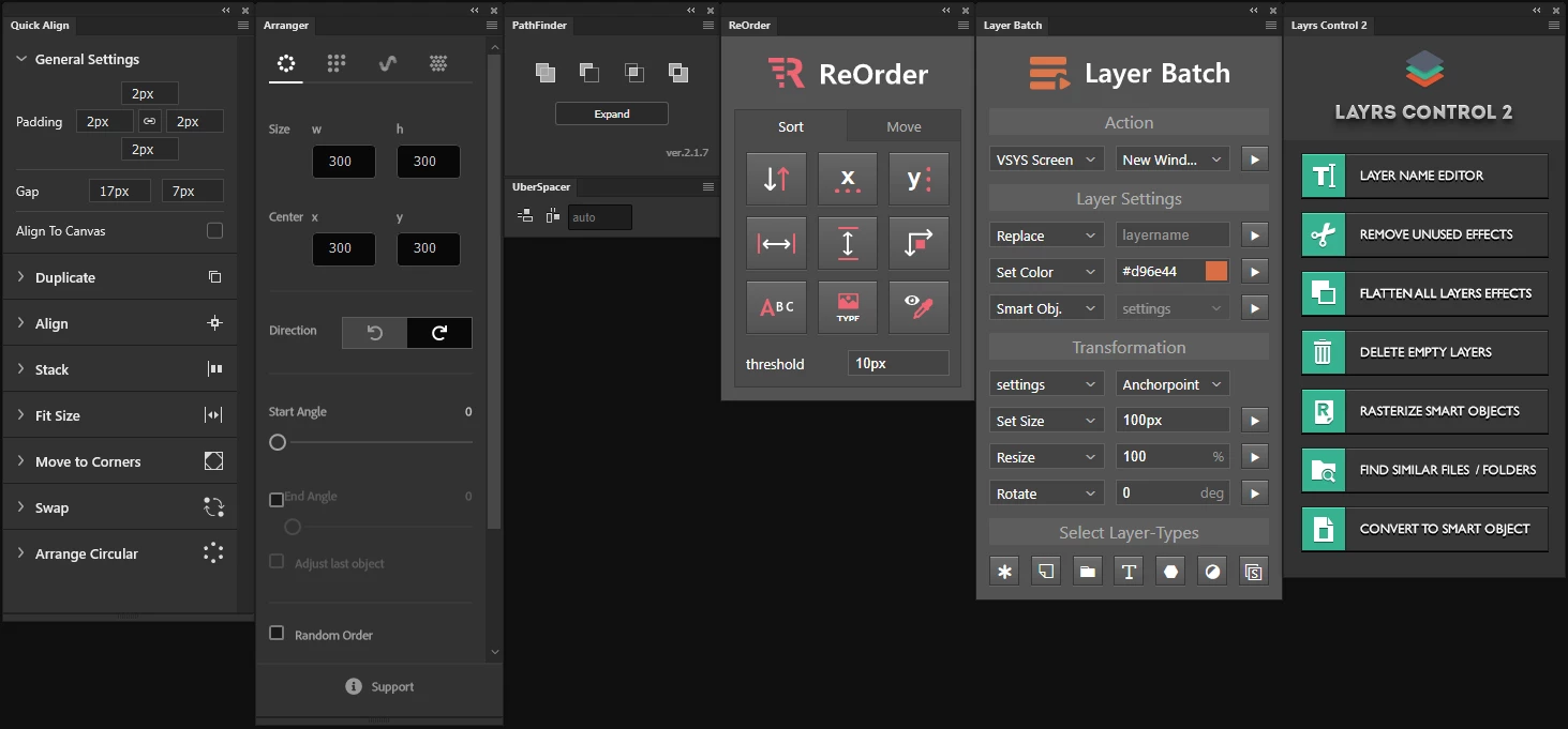

I've been actively upgrading my Photoshop workflow with vairous scripts and actions. Here's my actions panel now:
Here are my most used addons:
1. [Unsolicited link to paid for product removed - this breaks forum guidelines]
2. Arranger
3. Pathfinder for Photoshop
4. Uberspacer
5. ReOrder
6.[Unsolicited link to paid for product removed - this breaks forum guidelines]
7. Layrs Control 2
As well as Chameleon Adaptive Palette:
I mainly use Photoshop for screen work and Icon Design. I'm really curious about what workflow enhancements all of you are using on a daily basis. One missing element to my workflow is a good layer renamer. I came across  Renamy and it looks great.

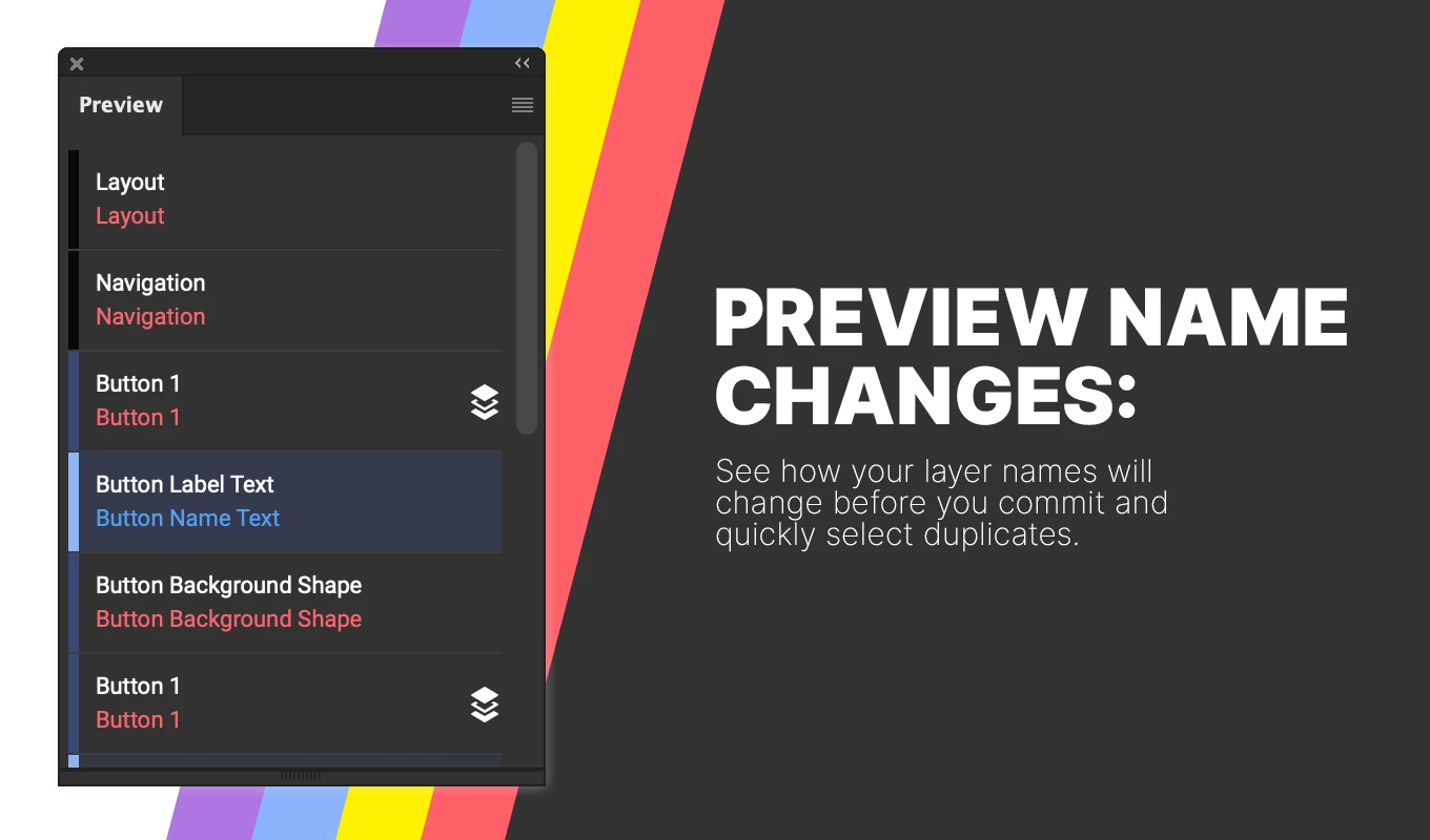

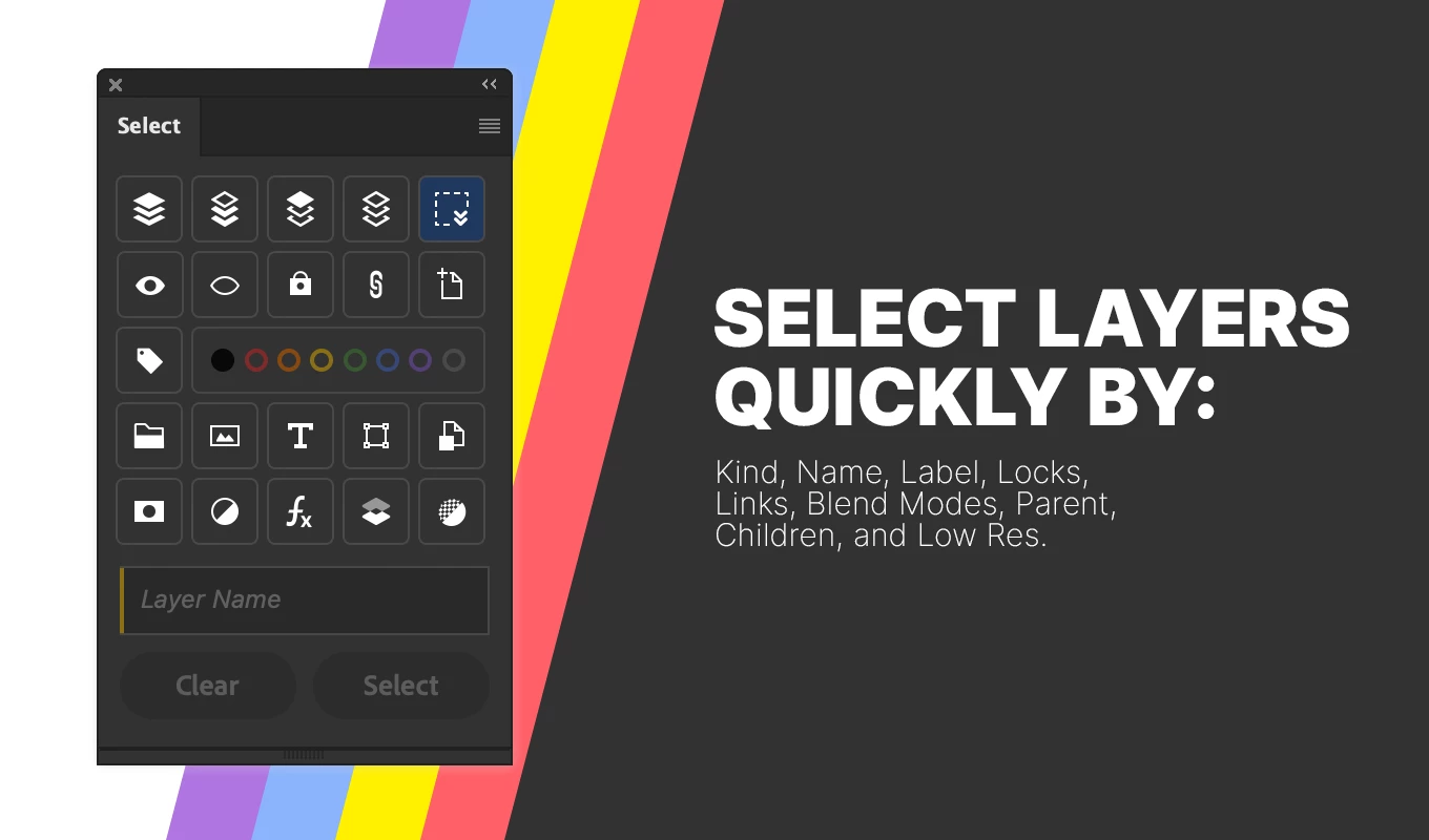

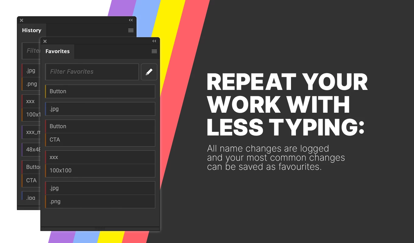

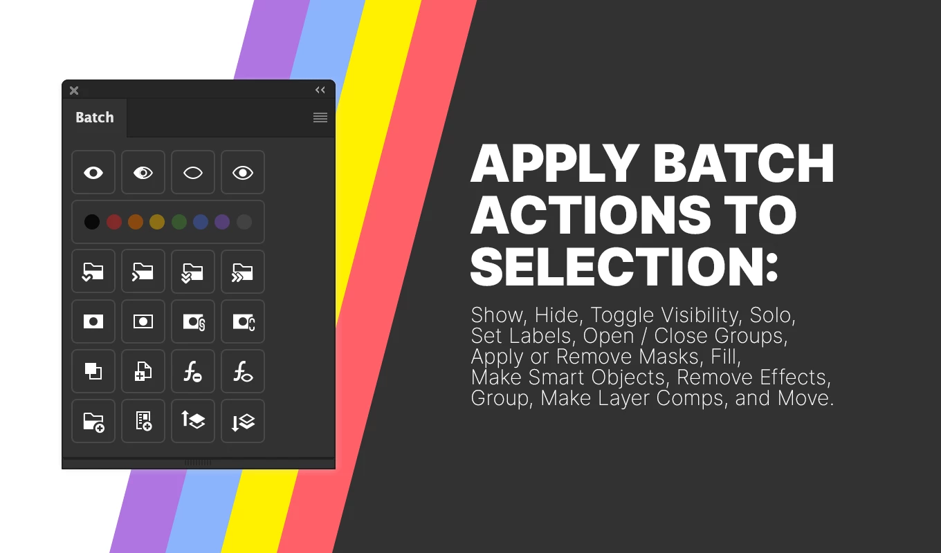

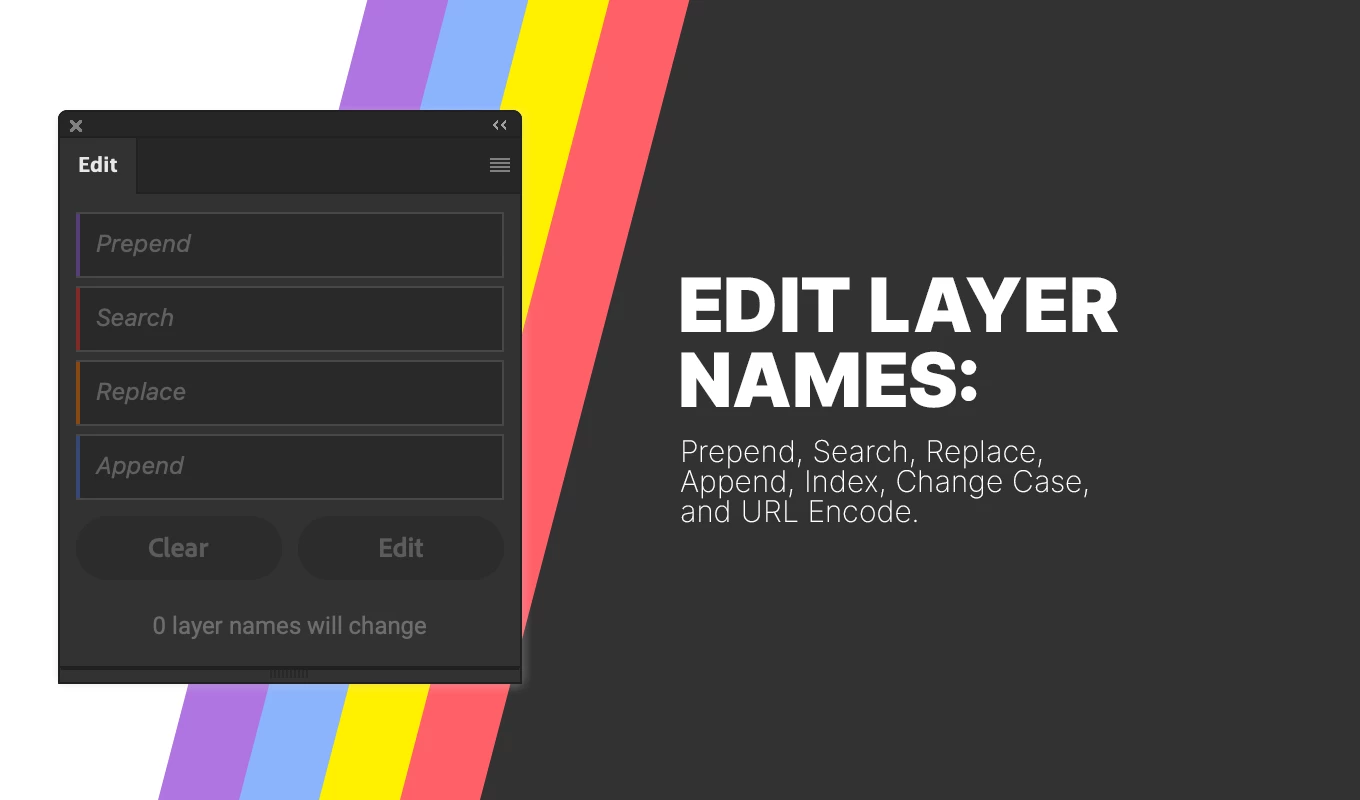

Check out our new plugin available on the CC MarketPlace
https://adobe.com/go/cc_plugins_discover_plugin?pluginId=c36e02fb&workflow=share
It greatly speeds up the process of selecting and renaming layers. And can also perform other batch process that have always been a big pain when working with a large number of layers.

futuremotion6798557
April 26, 2023
Bought it! It's great. Thank you for developing and sharing the link!
