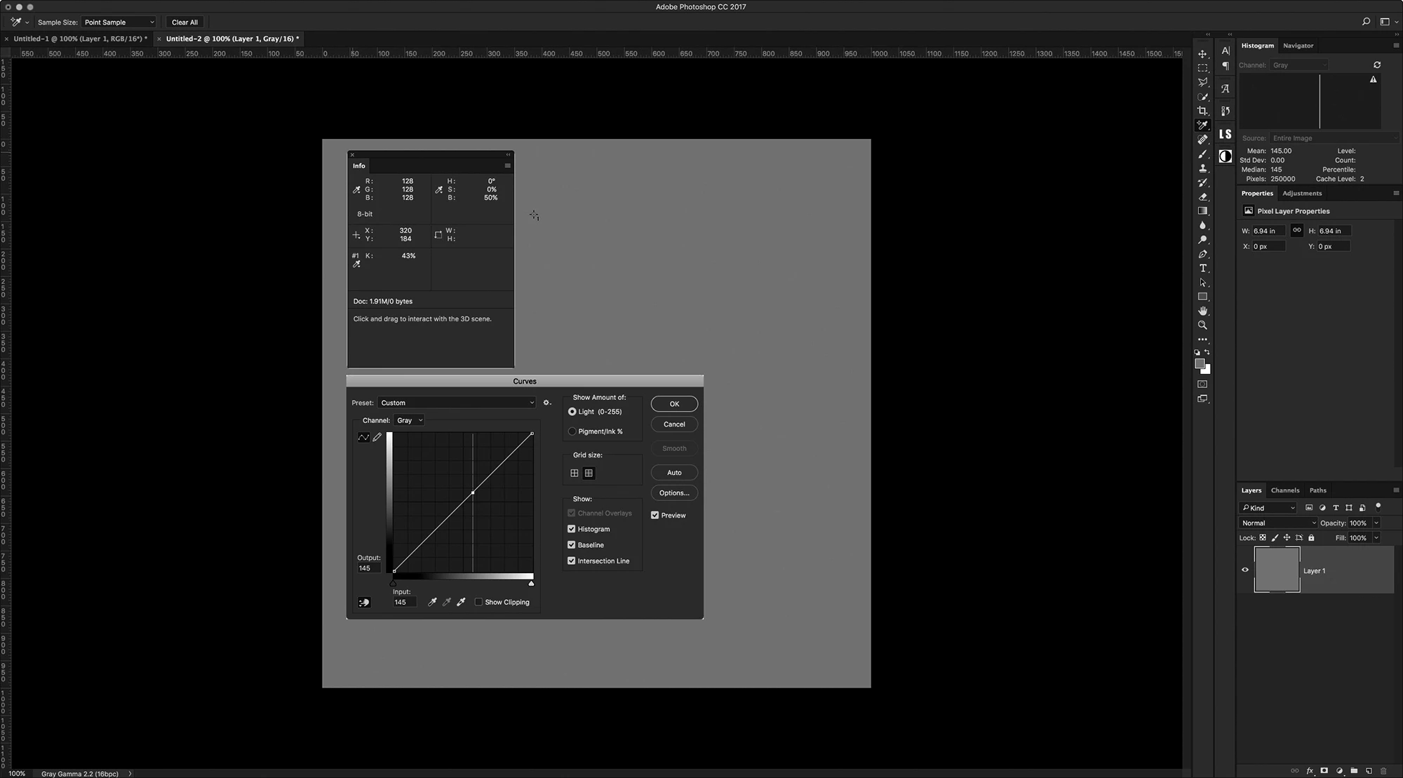

I created a new Document in Gray Gamma 2.2
I filled the layer with RGB 128,128,128
Placing a target point on the gray layer, the Info Panel Reports
RGB 128,128,128
K: 43%
HSB: 0,0,50%
Plotting the point with a Curve, the Input value reads 145
Can anyone explain why the K: value is not 50% and why the Curve Input in not 128

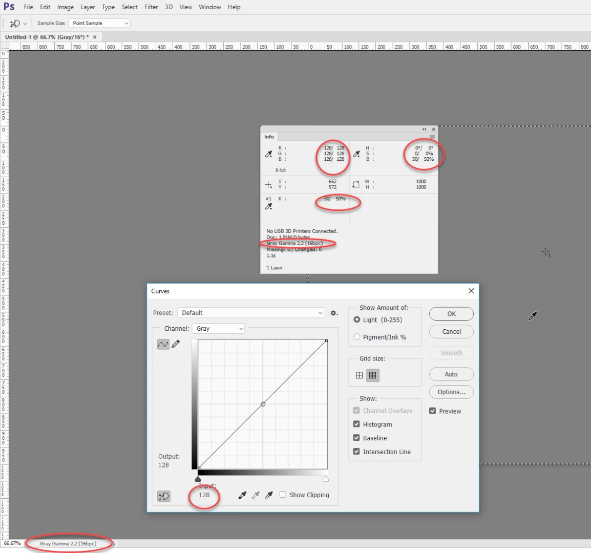

June 24, 2017
Hi Ian
I can't see what is going wrong in that screenshot. Here I've used the same settings as you are using - but with different (and as expected) results
Dave
IanBarberAuthor
June 24, 2017
davescm​ hmm...  Your screenshot is what I was expecting to see.
I am going to do this again just to make sure I never overlooked something
IanBarberAuthor
June 24, 2017
Still getting the same. I am mystified as to what could be causing this
