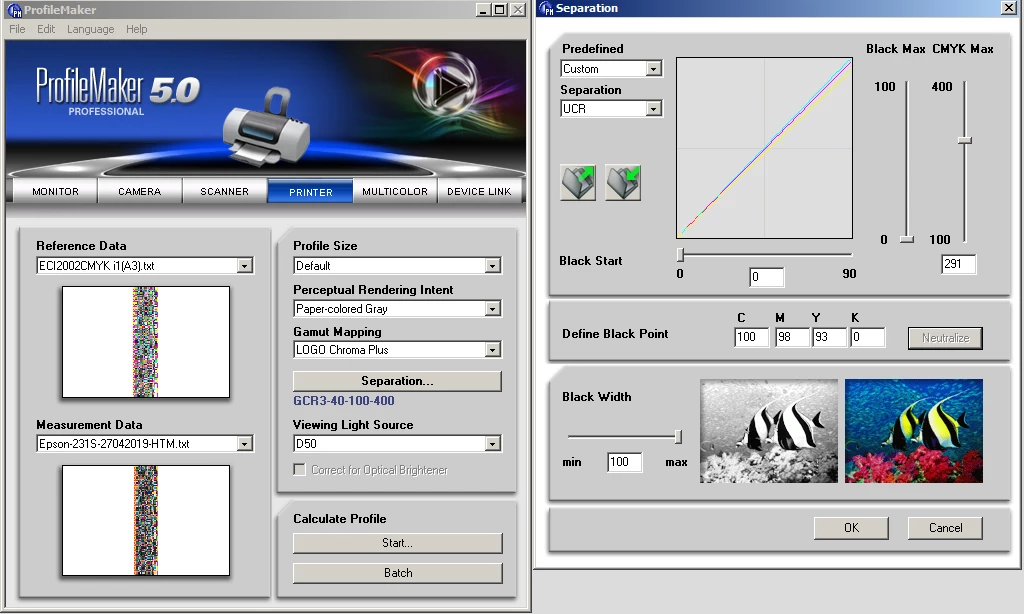

    The "best way" is to open the file in Photoshop and convert it to the appropriate
    CMY colorspace, represented by an ICC-profile which was made for the special
    paper, the special ink and the special printing process.
    The creation of this profile requires:
    a) print a CMYK target onto the paper using exactly the chosen process.*
    b) make the profile using instead of common UCR/GCR modes one which contains
    no K ink at all (Black Max = 0) :
    *) Why one cannot use a CMY target? In my opinion, that's simply not common.
    As a result, this profile, that is in fact the printing process, will not show a neutral black.

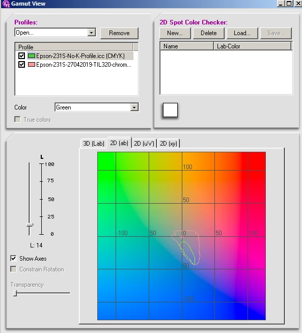

    See green curve (the red curve belongs to a CMYK profile). An the darkest CMY black
    is not as dark as CMYK black.
    Achieving a good gray balance over the whole lightness scale by manual adjustments
    will be very difficult (impossible, IMHO).
