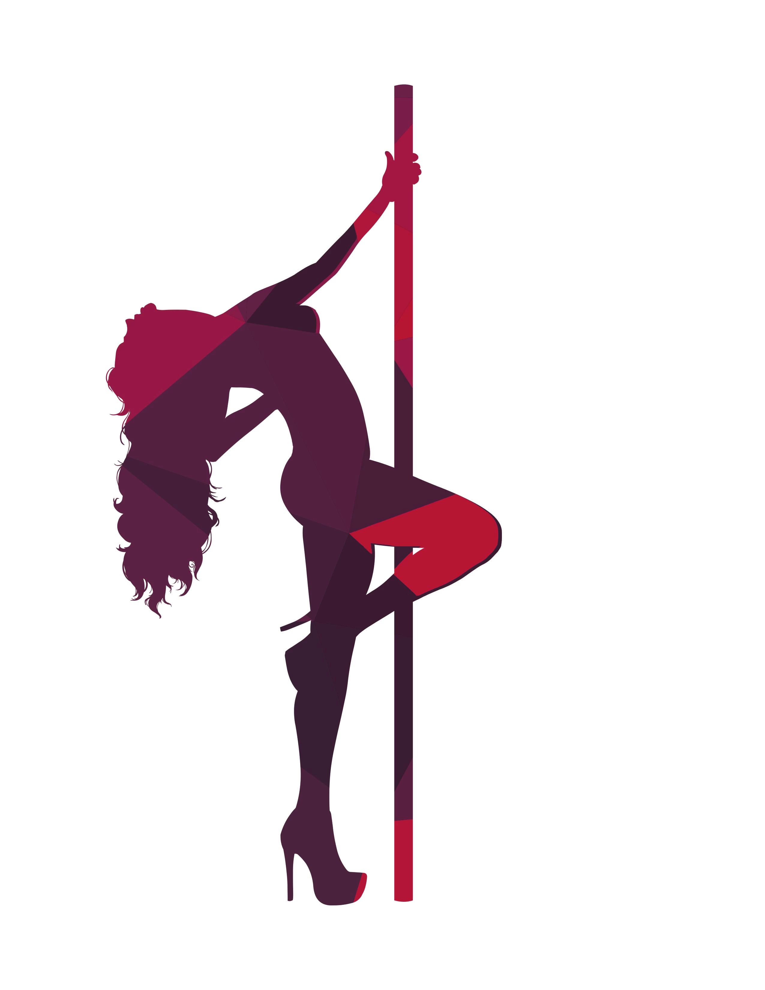

Here's my issue: I'm doing the design for a literary magazine's anniversary issue and have never been formally trained. Here's my panic: We started out thinking this book would be four color and therefore used CMYK color profile. But now it's black with one spot color, so I have to convert all the images to Multichannel mode and, according to the printer, I should have two channels only: black and the pantone spot color (in this case, Pantone Warm Red C).
So here's the favor I'm asking for: Can someone give me the basic 1-2-3 steps they would to follow to change the PSD file for this image from CMYK to Multichannel black + Pantone Warm Red C? I'm having so much trouble with this. I've been researching and experimenting, but I'm quite confused about layers, transparency, overlays, all that. The CMYK color mode file has two layers: a vector silhouette (the woman) with an image overlay (the pattern fill). I know how to change to multichannel mode, and I'm able to add a new spot channel, but it just isn't working right. When the layers all merge together, I'm stuck with either a solid red background and don't know how to make it be an overlay over the vector silhouette or it won't show the red at all. Either way, and I lose the transparency, even when I save the file as DCS 2.0. I asked the printer for guidance several days ago, but they haven't responded.
I know it's the day before Thanksgiving, but if someone could just give me the steps they would follow to change this CMYK file to a multichannel file with black + one spot color and still maintain the transparency, overlay, etc., I'd be most grateful. Basically, how do I make it look like this original image using only two channels?

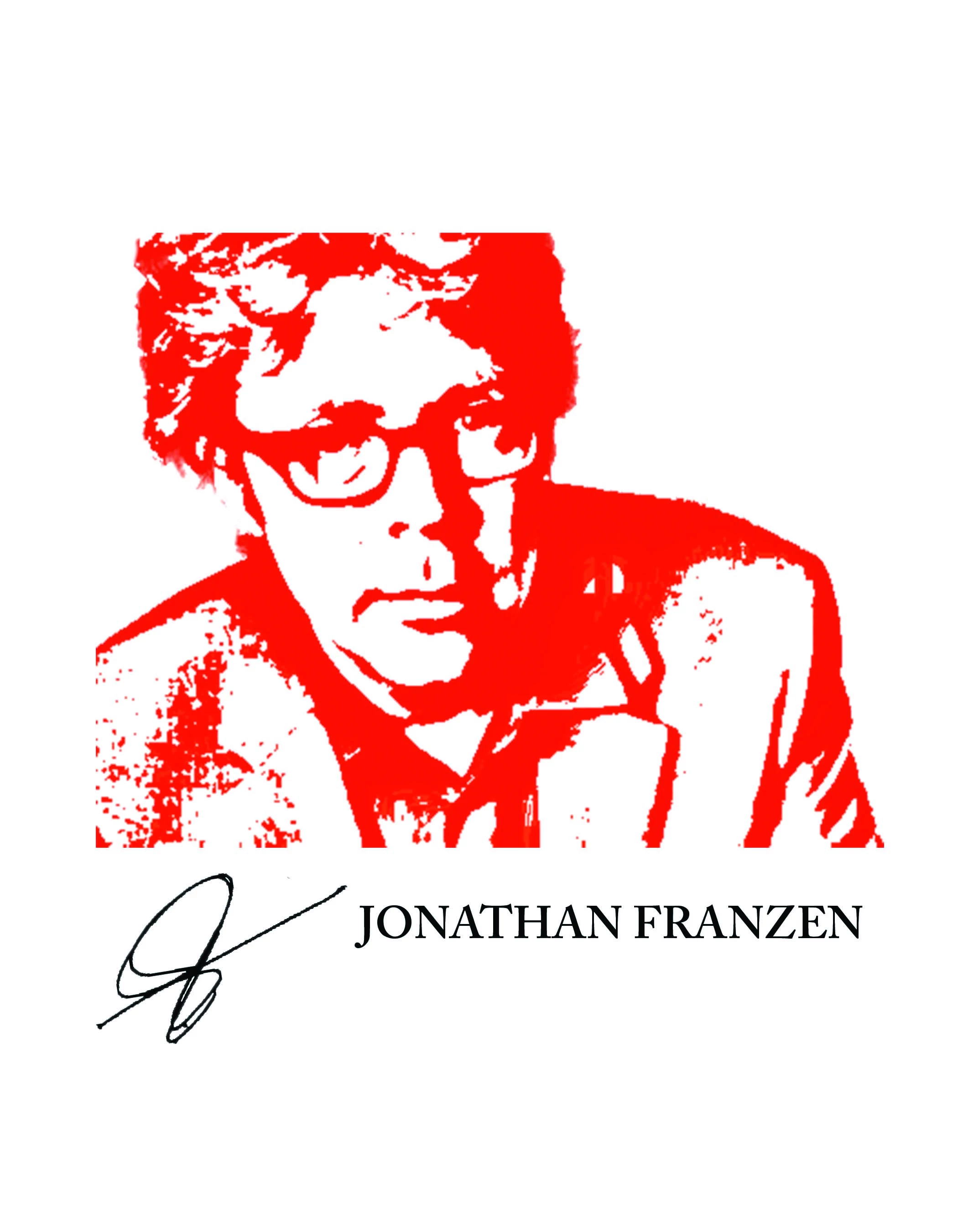

    The time and effort you've already put into this is an astounding kindness, and I am so thankful. And guess what? The saturated version did the trick!! I have about 45 images I have to alter and it's been a disaster of a day but you've turned it around.  (And thank goodness you're in Australia and helping people on these forums, not busy stuffing a turkey for Thanksgiving in the US!)

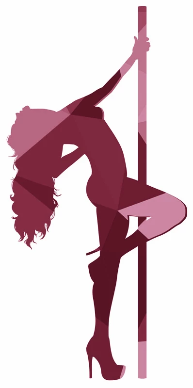

    The forum software changed the file to a JPEG (but still CMYK). You would need to upload the original PSD to say DropBox or another file sharing service.
    Are all of the images similar to the one attached? Often conversions are image dependent, what works for one image may not work for another.
    Make sure to keep the CMYK originals and work on duplicated files so that you can recover if things go wrong.
    I’ll post a link where you can download an action (no guarantee or warranty provided/implied, use at your own risk)… The Photoshop preview is not very accurate, so the print result may or may not be anything like the “softproof”.
    Attached is a “preview” of a 2 channel conversion, the original was multichannel however this is in CMYK mode, still 2 channel with a “faux preview ICC profile”…

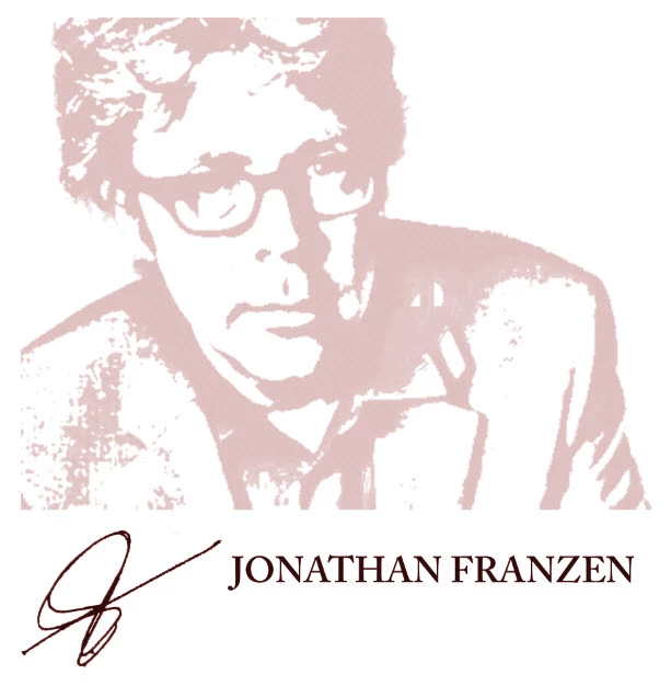

    And please forgive me for my greed, but now that I have your expertise, may I ask one more question? When I run the action, the colors are very muted in some. For example, I'm attaching an image with the CMYK and then the image with the two channel. Is it possible to make the red more saturated and vibrant?
