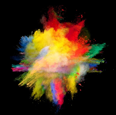

I have a full colour RGB image of an explosion of mulitple paint colours on a black background. I want to change the explosion of colours to our brand teal green colour, with the background C 0%, M 0%, Y 0%, B 100%.
I have converted the RGB image to greyscale and then to duotone. Then set up my two inks. A 100% black and a CMYK teal green colour.
The image will be professionally printed. To avoid any problems with the duotone I want to convert it to CMYK. But when I do this, the black background becomes C 91%, M 79%, Y 62%, B 97%.
This is way too much ink density.
I was hoping that the the black would simply stay C 0, M 0, Y 0, B 100%.  i.e. overprint / knockout the teal green that is 'behind' it. Instead the two inks (the black and teal green) and combining, making the black unprintable.
1. Any idea how I convert the duotone to CMYK without the black ink density becoming unprintable?
2. Or how I change the colours in the explosion to our brand colour (without using a duotone) and the rgb background to a solid CMYK (100%K) black

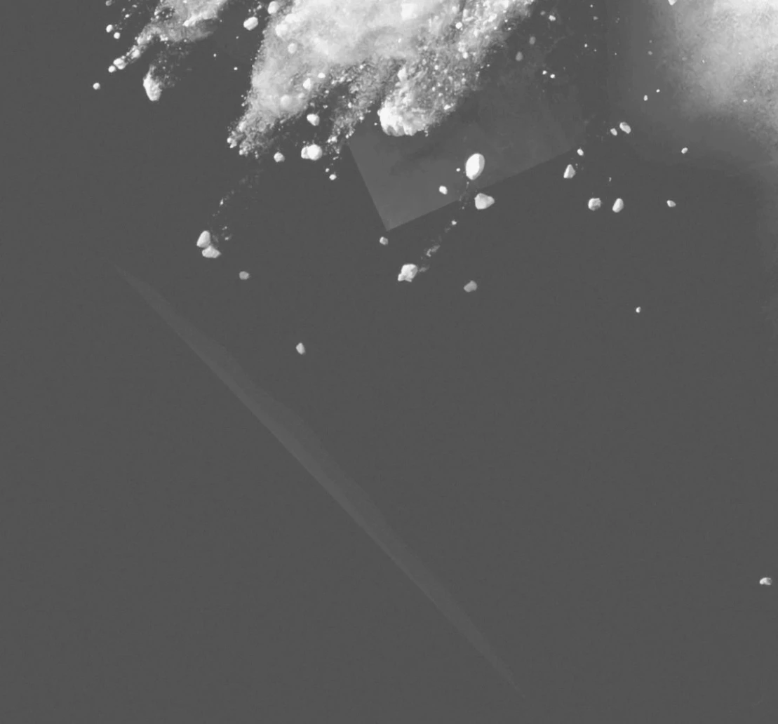

The image seems to show traces of previous editing:
October 3, 2017
I've just had a quick look. I think that is the only example of something odd. I bought the image from Adobe Stock, so I'd be upset if there were more issues with the image

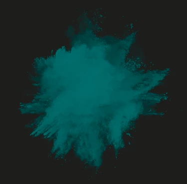

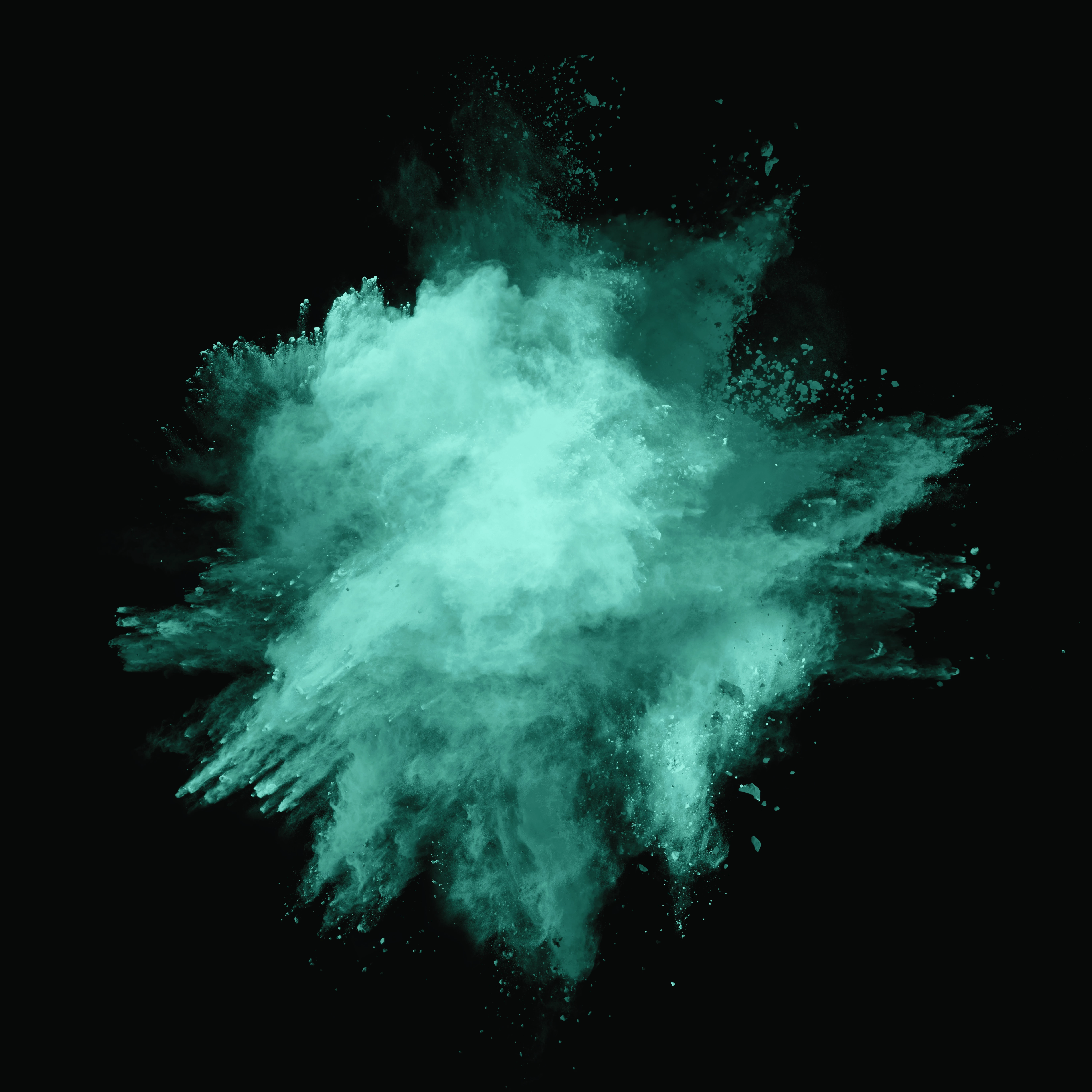

Original full colour RGB image.
Duotone image
I need the black background to be C 0, M 0, Y 0, K 100%
And the explosion to be our brand green C 100%, M 0, Y 45%, K 40%
But when I convert from duotone to CMYK the black background ends up as C 91%, M 79%, Y 62%, B 97%
which no printer will want to print cos' there is too much ink.
