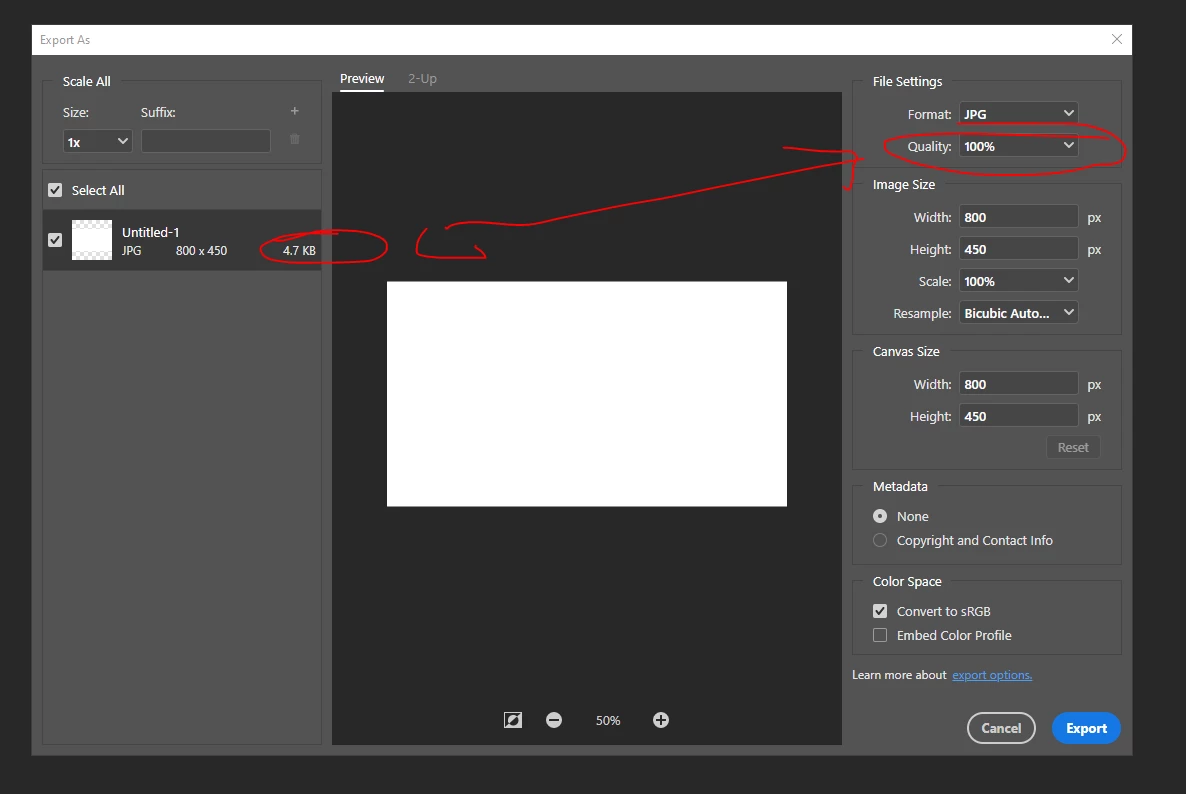

There isn't any magic, but you can try adjusting the JPEG quality slider.
Save For Web (legacy) may give more levers.
If it's still too big, reduce the pixel count, checking it still meets the rules.

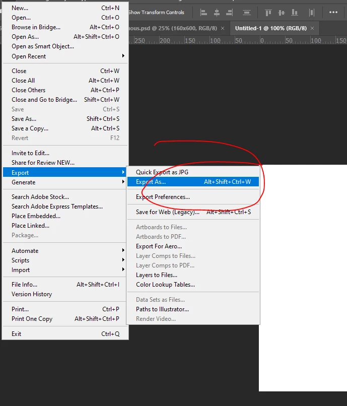

Many thanks to all of you for your very helpful suggestions.  I believe that my main problem was that I was looking for a "save as jpeg" rather than using the "export as!"  This should make it fairly easy for me to come up with five entries,  Mch appreciatedm=, everyone!

Use "Export as..." and there you can set the percentage and play with it until you get the output file size to where you need it.

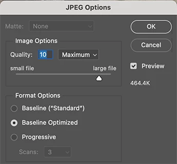

Did you want to keep the original size or reduce it to something acceptable? A 6000px x 4000px image might be too large and if the contest doesn't mind 3000 x 2000, that would help knock down the file size.  So using Image Size, resize before saving. Keep backups of your master psd files before doing any of this.
I use "Save As Jpeg" because i can see the file size vary as I move the slider. I think 10-12 is acceptable quality.

D Fosse
June 27, 2023
I think quality 8 or 9 is optimal for jpeg. The file size is dramatically reduced, while the immediate appearance of the image will be just as good.
The reason jpeg has been so successful is that the degradation is usually not visible on the first save. It only becomes apparent with repeated saving, and after a few saves it starts to disintegrate. But as a one-off final delivery, 8 or 12 makes no discernible visual difference.
So you may as well get substantial payoff in reduced file size while you're at it.
Just don't make the mistake of resaving and reusing it. A jpeg is a one-time-only throwaway file copied out from your PSD or TIFF master files.
