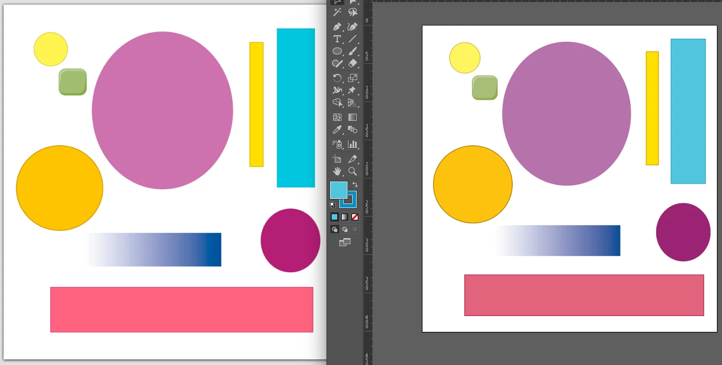

I am trying to troubleshoot an issue with CMYK designed .eps files that were given to me to alter in Illustrator and display via a web link.  I am finding that everything looks great right until I try to post the exported .pngs or .jpegs to web display.  This is not a problem with other images that have been posted to the same web displays, and it happens in more than one platform.  I have been trying all kinds of variations on color modes, and settings within Illustrator.  I believe that the problem is coming from the .eps in the first place.  But now I'm wondering if I can't do something to the exported pngs and jpgs in Photoshop that would drop whatever color information is throwing a wrench into their web appearance.  Does anyone have any experience with something like this?  Here is an example of the kind of color differentiation I'm seeing.  But rather than the usual problem of an RBG image getting dulled when converted to CMYK, I'm struggling with a CMYK image that becomes oversaturated in the web's RGB space.  And so far I haven't been able to find an RGB conversion setting that fixes the problem.  Suggestions?

I just went back and ran through it all again with the color profiles embedded.  The result is the same.  Something causes my files to become oversaturated upon web display.  I believe that it has something to do with the embedded color information.  But so far no combination of preserving or turning off embedded color information has solved the problem.  This is not a monitor issue.  The same image is displaying substantially differently on the same monitor.  My initial picture is a screen capture of the same image shown through preview or uploaded for display through a link.  It's the same monitor, at the same time.  I am still looking for a way to make these images display correctly.

I am using an iMac, running macOS Sierra with an NVIDIA graphics card.  I also have a View Sonic side monitor.  I have calibrated my screens, but I do not have a separate calibrator outside of my computer's calibration, and Adobe.  The problem also appears on the monitors of my coworkers, across a wide range of screens.  The problem does not occur with images that I, or my coworkers have made from scratch.  This is why I suspect something being mistranslated in the embedded color information of the original .eps.  I have also read about problems where .eps files don't always change color profiles well.  But it sure seems like I could make some sort of conversion that would remove whatever piece of information is tripping up the color display, or preserve whatever piece of information is being lost if that is the case.  Taking a screen shot of the image in Preview, or on the Illustrator, or Photoshop, board and uploading that for display presents the colors correctly.  But I'm looking for a way that I can use these .eps files in Illustrator, and then export pngs that can be displayed correctly when uploaded for web display.  I was hoping that Photoshop would allow me to run some sort of conversion to the exported pngs beyond what Illustrator could do that might preserve the intended colors.  So far, that does not appear to be possible.

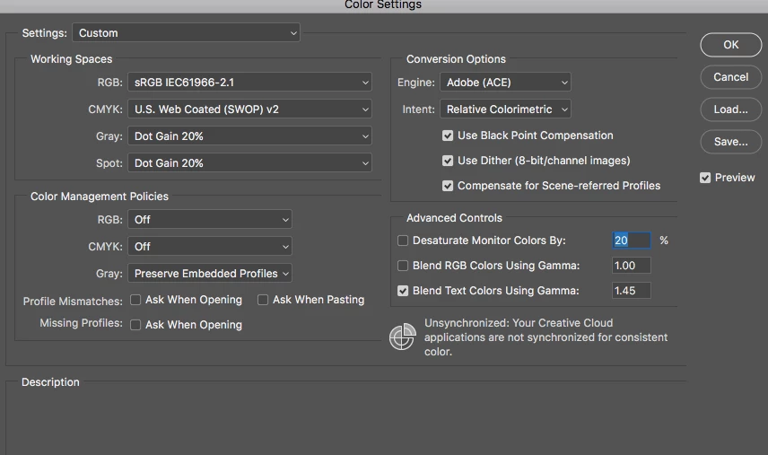

This is a screenshot of the color settings as they open initially.  I changed the custom setting to North America General Purpose 2 and then I exported for web with the settings shown above.

Is the screenshot of the color settings from Illustrator? I think you can do everything there with no need to use Photoshop.
I don't use Illustrator, but I believe it has Save for web.
The problem is that you have Color management policies for RGB and CMYK set to Off, which disables color management.
Set them both to Preserve embedded profiles, then restart Illustrator and start over.
Open the eps, save it as .ai, then use Save for web to export.

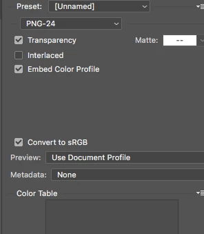

Open your file in Photoshop. Your color settings should be North American General.  Ctrl/Cmd + Shift + k
Your monitor should be correctly calibrated and profiled.
If it is in CMYK mode, you may have to do a profile conversion from SWOP to sRGB (web)
Usually File > Export > Save for Web will work. There you can choose png. Use these settings:
Then open the exported PNG to see if the colors are correct.
