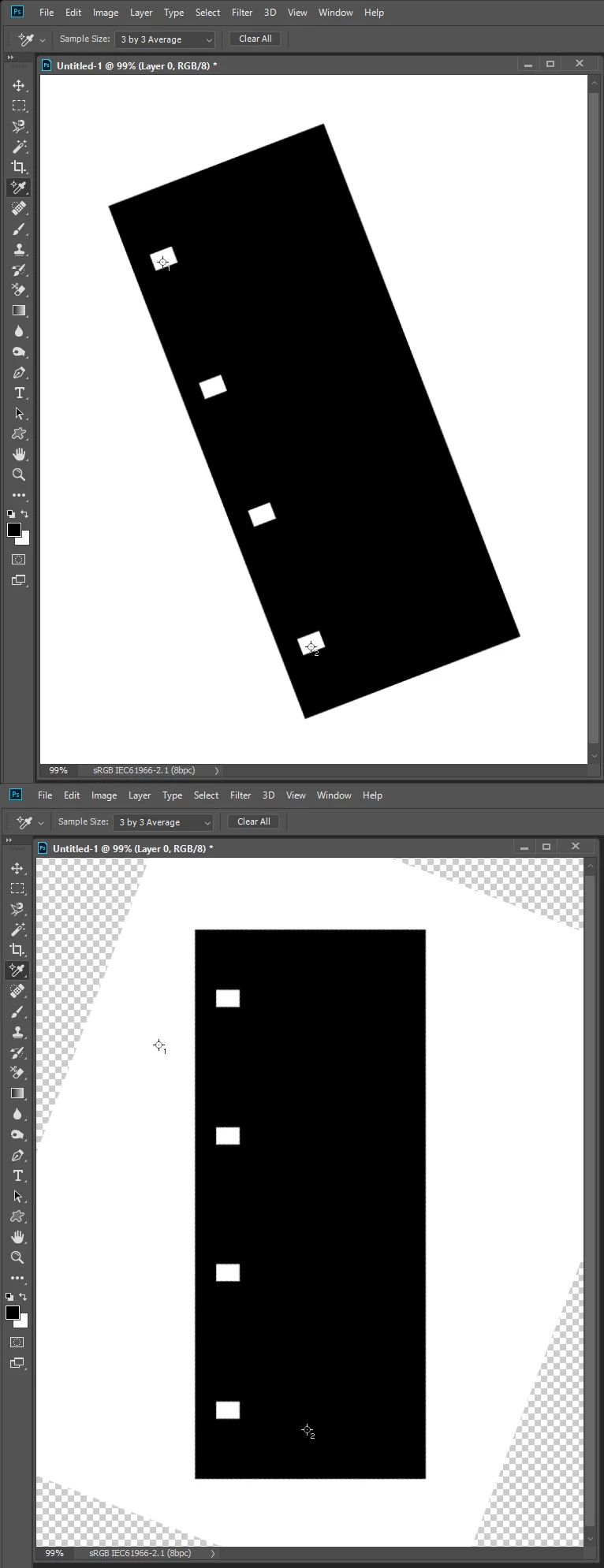

The script you want may work like this one.
// Save the current preferences
var startRulerUnits = app.preferences.rulerUnits;
// Set Photoshop to use pixels
app.preferences.rulerUnits = Units.PIXELS;
Main();
// Return the app preferences
app.preferences.rulerUnits = startRulerUnits;
function Main() {
if (app.activeDocument.colorSamplers.length!=2) {
alert('two color sampler points are required');
return;
else {
point1 = [];
point2 = [];
for (var s=0,len=app.activeDocument.colorSamplers.length;s<len;s++) {
var colorSamplerRef = app.activeDocument.colorSamplers;
MagicWand( colorSamplerRef.position[0].value ,colorSamplerRef.position[1].value);
if (s==0) point1=TopLeft();
else point2=TopLeft();
app.activeDocument.selection.deselect();
   Rwidth = point2[0]-point1[0];
   Rheight = point2[1]-point1[1];
   degrees = Math.atan(Rwidth/Rheight) * 180 / Math.PI;
   app.activeDocument.activeLayer.rotate(degrees);
function TopLeft() {
try{
TL=[];
var SB = app.activeDocument.selection.bounds;
TL[0]=SB[0].value;
TL[1]=SB[1].value;
return TL;
catch(e){}
function MagicWand(Xpoint,Ypoint) {
var idsetd = charIDToTypeID( "setd" );
    var desc121 = new ActionDescriptor();
    var idnull = charIDToTypeID( "null" );
        var ref33 = new ActionReference();
        var idChnl = charIDToTypeID( "Chnl" );
        var idfsel = charIDToTypeID( "fsel" );
        ref33.putProperty( idChnl, idfsel );
    desc121.putReference( idnull, ref33 );
    var idT = charIDToTypeID( "T   " );
        var desc122 = new ActionDescriptor();
        var idHrzn = charIDToTypeID( "Hrzn" );
        var idPxl = charIDToTypeID( "#Pxl" );
        desc122.putUnitDouble( idHrzn, idPxl, Xpoint );
        var idVrtc = charIDToTypeID( "Vrtc" );
        desc122.putUnitDouble( idVrtc, idPxl, Ypoint );
    var idPnt = charIDToTypeID( "Pnt " );
    desc121.putObject( idT, idPnt, desc122 );
    var idTlrn = charIDToTypeID( "Tlrn" );
    desc121.putInteger( idTlrn, 20 );
    var idAntA = charIDToTypeID( "AntA" );
    desc121.putBoolean( idAntA, true );
executeAction( idsetd, desc121, DialogModes.NO );

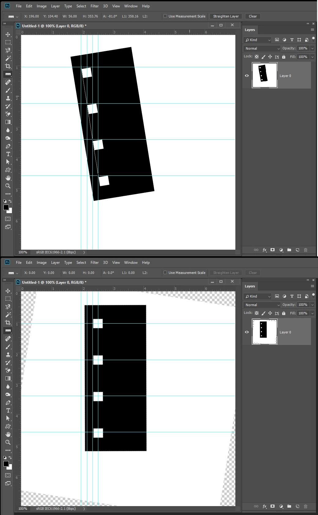

Please do not keep opening addition threads for the same subject. Sprocket holes may damaged.  But as chuck wrote if you do one sprocket at a time you can get the bounds of each.  Using the top left corner point of each you may be able to set a Photoshop ruler then use straighten. If that is possible I do not think it would matter what the distance between sprocket holes is any two holes could be used and Photoshop would calculate the rotation angle. Its a simple right triangle calculation. Your script could of course also do the math instead of Photoshop. However after the rotation the holes would move in an arc and now have different bounds

How are you defining the the two selections for the sprocket holes, or are you? If you know the general distance between the two holes, you can select, say, the top one, then interpolate where the second might be and use AM code to do a magic wand sample in the general area of the second sprocket hole. In this way, you can save the first selection to a variable, the deselect and have your script select the second and compute the needed rotation.
