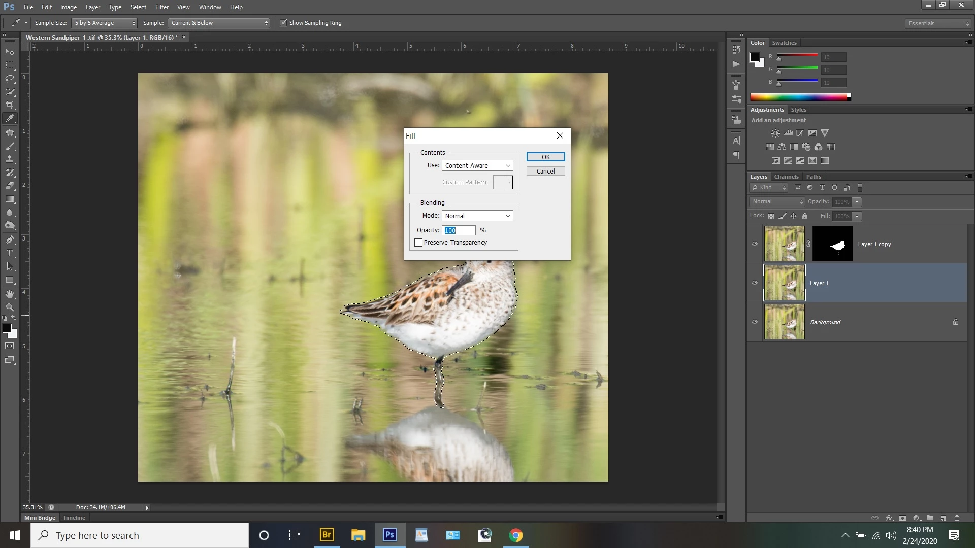

February 25, 2020
I'm having the same  problem but it is intermittent and the above replies did not help. Attached is a screenshot of the active layer and dialog box The bird has been  selected
