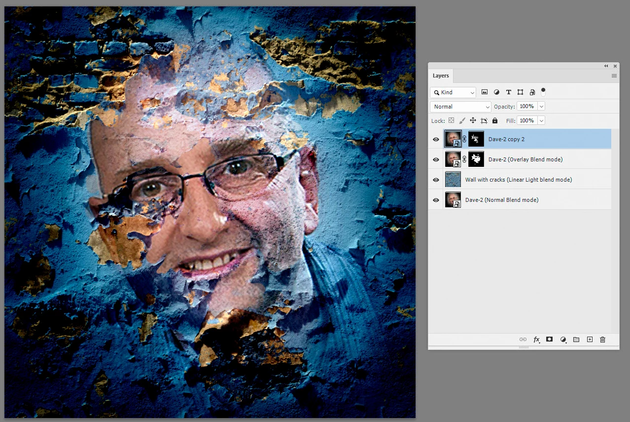

You can build up such an effect with layers, blend modes, and painted masks. This quick example starts with a cracked wall image and a simple face image. I have shown the blend modes in the layer name for each layer

The two layers could be combined in that way by adding the texture layer in front of the face, and then applying a layer blending mode to the texture layer; and then using a mask on the texture layer to keep the texture out of the left side of the face. As you can see in the demo below, once you know which steps need to be done, this can be done in about a minute.
