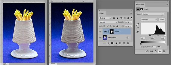

    Norman Sanders
    July 10, 2019
    One approach that offers flexibility is to make a Selection of the area you want to change, add a Levels Adjustment Layer and use the sliders  (in the Properties panel) to adjust the tone.
